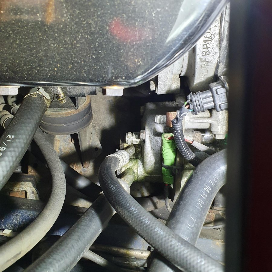

The engine number is stamped vertically at the front of the block, on the right-hand side, just in front of the chrome exhaust heatshield. See the photo below for an example of my car. The VIN plate is visible through the windscreen on the LH side of the dash. The VIN is also stamped into the horizontal front ledge of the plenum chamber, visible when the bonnet is open. Effectively the centre of the closing panel of the bonnet.
