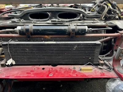

Looking at the picture of my car, I can see where the narrower cooler would go, on the right facing (all the holes are there), it already has some air flow restriction due to the receiver/dryer and cross bar, but opens up a better air flow on the left facing with the CCC6982 cooler ,through to the evaporator and radiator.
I am not worried about the oil pipes as I can buy bespoke, racing stainless braided hoses with a degree of re-routing etc.
The second picture you can see the narrower one (upside down of course).
