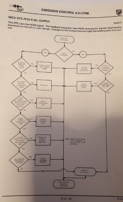

I followed the Jaguar diagnostic logic sequence, as described below, and then went off on my own tangent!
So:
Step 1) Check Lambda sensors - all ok, as replaced by DM.

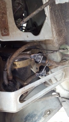

Step 2) Check EVAPP (electronically controlled purge valves in the front LH wheel arch) - I checked & cleaned the connections and determined that they were responding to the ECU as you can feel them "pulse" when the car is warm at idle. However, I could not confirm if they were sealing correctly, so I have found some New Old Stock (from Australia!) and will fit them when they arrive.
Step 3) This is where the diagnostics gets a bit vague - it basically asks you to look to see if any other fault codes come up and rectify them! I can't read the ECU for any other faults - and I don't have a trip computer fitted (so I am having to guess that I keep getting the FF23 fault identified previously) so my only other item was fuel pressure. I can't find a source of new 6.0 V12 fuel pressure regulators (3.0bar) and I don't have an inline gauge to hand to check the performance of the current one (as has been demonstrated on this forum before).

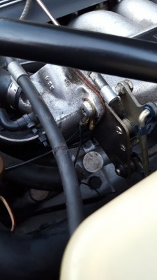

Sure enough - I found a small crack in the elbow of the vac tube to the MAP sensor in the ECU where it connects to the manifold - all fixed with a cable tie. I also cleaned the IATS connections to be sure.

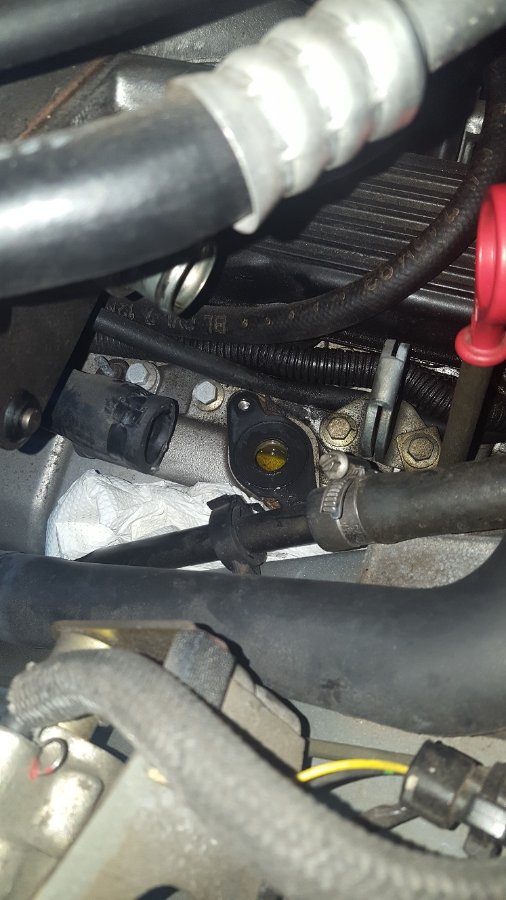

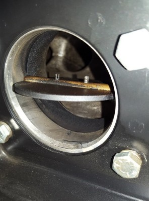

Step 5) Which led to cleaning of very dirty throttle bodies (see image - A bank)
and some adjustment of the idle screw on the AAV. I think the AAV idle screw has been adjusted fully out (to compensate for all the dirt in the throttles) and the valve was also sticking on operation, hence allowing too much air in and thus acting as a leak into the intake -> hence the Check Engine light as the ECU tried to correct for it. I think someone previously had this issue and had just tweaked the idle speed to fix it!

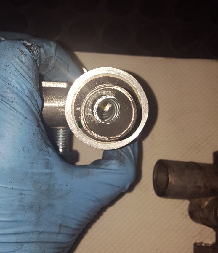

Hi all,
A bit of an update on my FF23 and high idle issues. I have made many things better, but it is still not completely fixed!

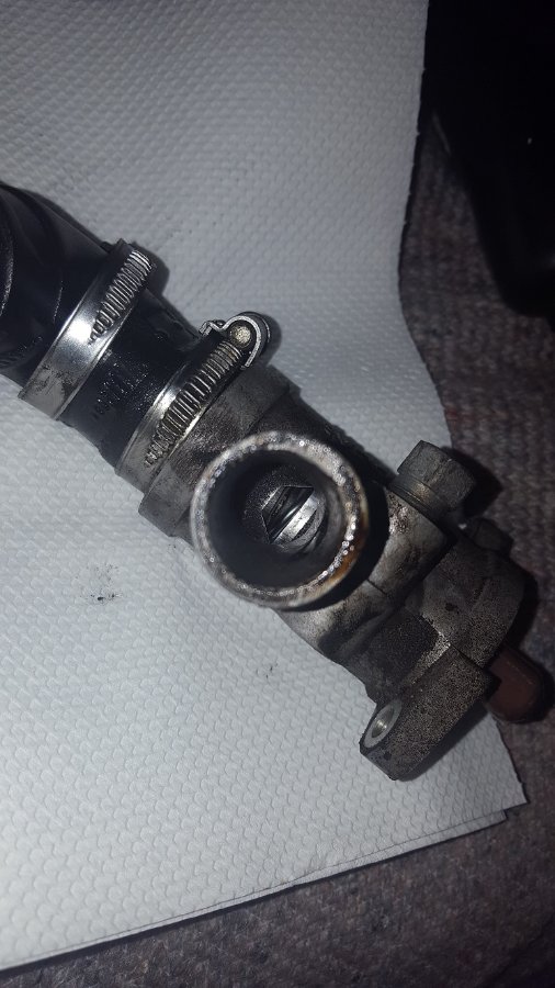

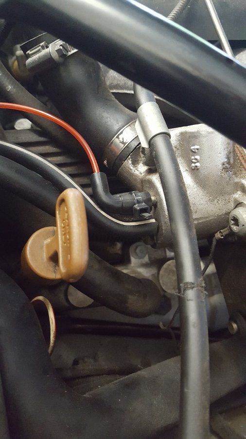

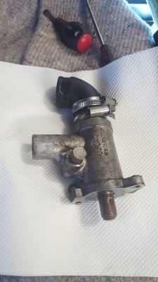

I have fitted the new AAV, along with the air valve to manifold hose which connects to it. As you can see in the pictures, the original was dirty but not completely gummed up. On examining the new OEM part, the internal spring appears to be different - with a smaller coil diameter and longer free length. It looked a bit odd and twisted, so I tested both in the kitchen with boiling water and they both close correctly. So on with the new part and keeping the original as a spare.
Before trying to get the idle speed correct with the new AAV, I checked both throttles for their position at idle, having previously cleaned all the muck out of them. They were nowhere near right! So I reset them as per the workshop manual with a 20thou feeler gauge at top. I also found that the throttle bell crank linkage on A bank was sticking when hot, so lots of cleaning and WD40 on the linkage got this moving correctly. I also made sure the cruise control actuator rod was moving freely and not binding up.

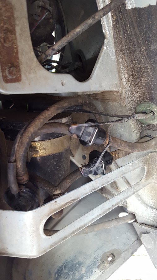

The 2 new EVAPP purge valves arrived from Australia and these I fitted, while checking that the connecting hoses were clear and not cracked.

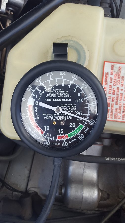

One final check I made, thinking perhaps that the CEL could be caused by a small constant vacuum leak, was to measure the manifold vacuum pressure at idle. I bought a simple gauge (with a 3"Hg offset error!) and hooked it up to the vac port on the intake manifold at the rear of A bank, next to where the Marelli ignition ECU vac hose is connected. At idle it showed a healthy 20.5"Hg with a small flutter of the needle, which smoothed out when the throttle opened. Consulting the manual for the gauge, it suggests that this could indicate loose valve stems, but as the car does not smoke or use abnormal amount of oil (0.5 litre every 1000miles or so) then I don't feel this is a concern. The key point is that the ECU is getting a plausible vacuum signal under load -> so unlikely to be the cause of my CEL.

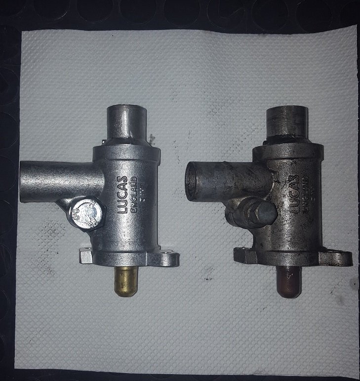

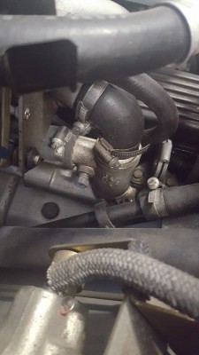

A few more pics.
Original AAV
A bit gummed up, but not terrible.
New and old AAV comparison
New AAV with odd spring
Original AAV

Marelli vacuum tube repair
Vacuum measurement at idle - note the gauge has a ~ 3"Hg error at zero, so this is actually reading about 20.5"Hg
As I said in the main post, I am now a bit stumped as to where to go next.....

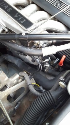

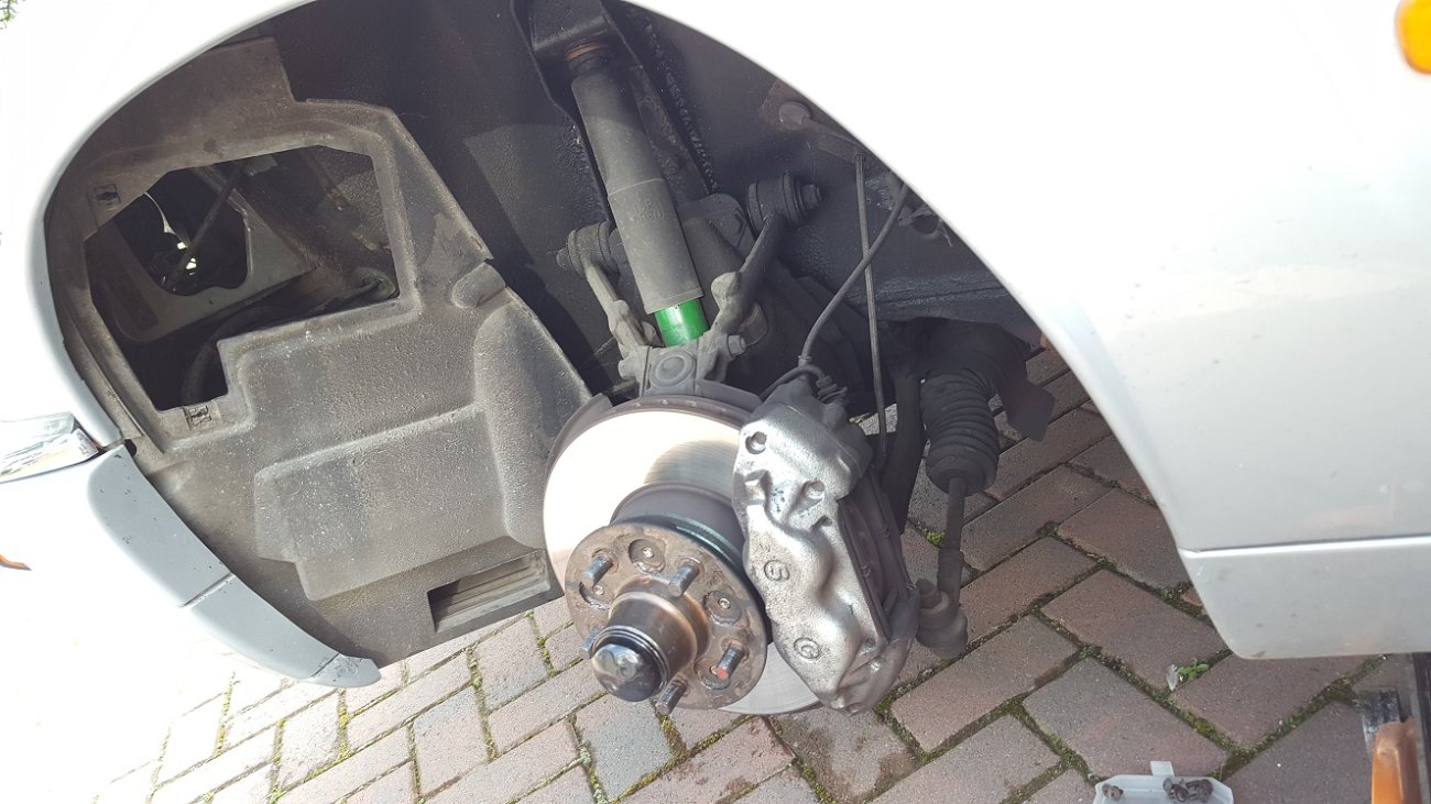

And finally, here are the images of the additional earth straps fitted which resolved the issue. 2 x new black earth straps per side with copper coloured fittings mounted to the back of A and B bank manifolds and down to their closest earthing points on the engine bulkhead.
I am very pleased that this one is solved.
I hope these posts are of help to others in future, who may have the same issue.
