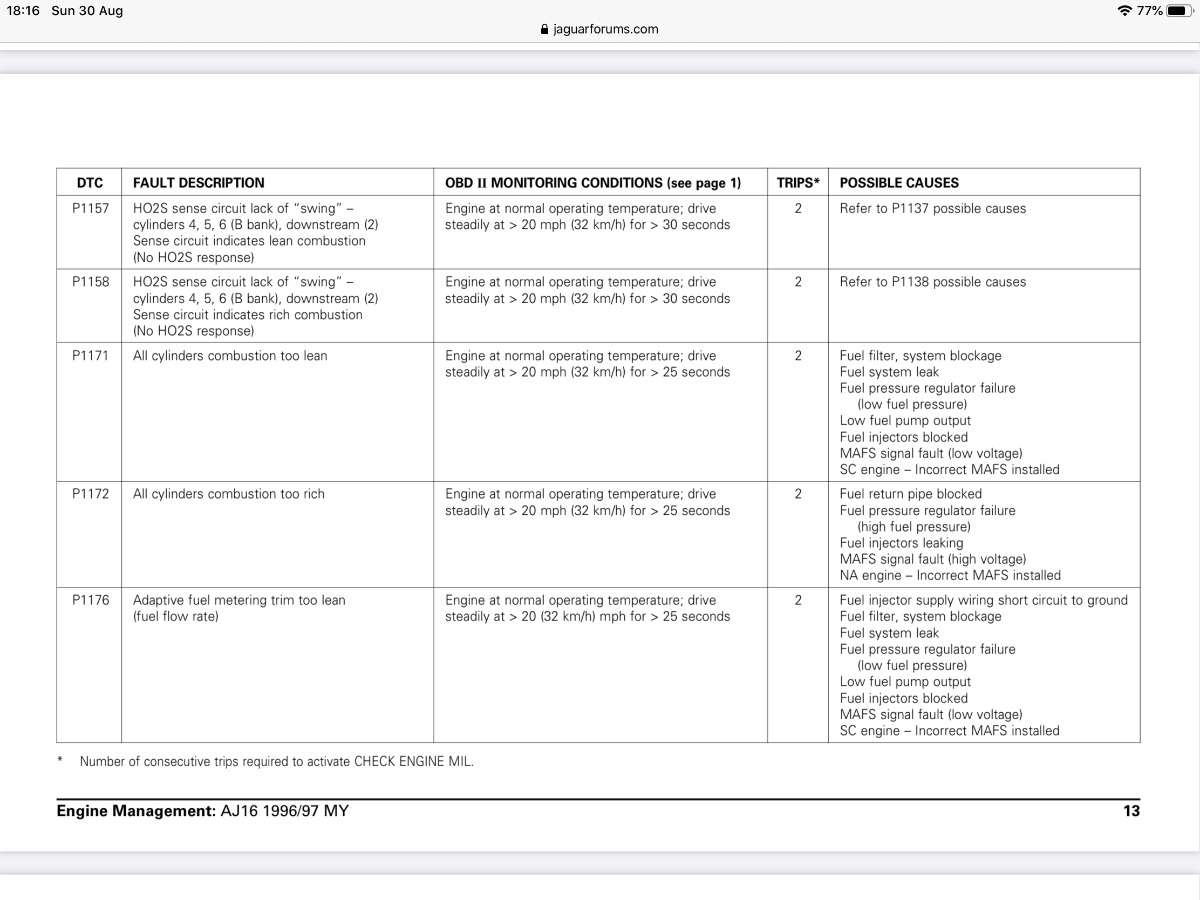

I'm getting a DTC P1177 which according to TB 18 -53 suggests the cause to be a rich fuelling trim so I'm now looking for air leaks on the intake side. I was going to clean as may electrical connectors in the chain with a good dose of contact cleaner, see what happens. I'm nor sure but maybe others can equate this code to a stall scenario. I also have a cracked converter, usual seam which I had welded back but maybe still a slight leak. Would this cause the problem? When I had the car MOT'd at the end of March the Examiner said he had to run the engine at high revs to get the O2 sensors to kick in. Do I need 4 of these? Also. Mine is Japanese spec so that there are also temp sensors, one on each pipe. Mine can stall both cold and hot so I'm guessing not.

Don’t know about stalling, but my book says P1177 is lean not rich and points to maybe fuel surply issues. Easy to change the fuel filter first, and clean the MAF.

Thanks - Most odd as Technical Bulletin 18 -53 definitely suggests the cause to be a rich fuelling trim. If I could work out how to insert an image I would give it a go.
