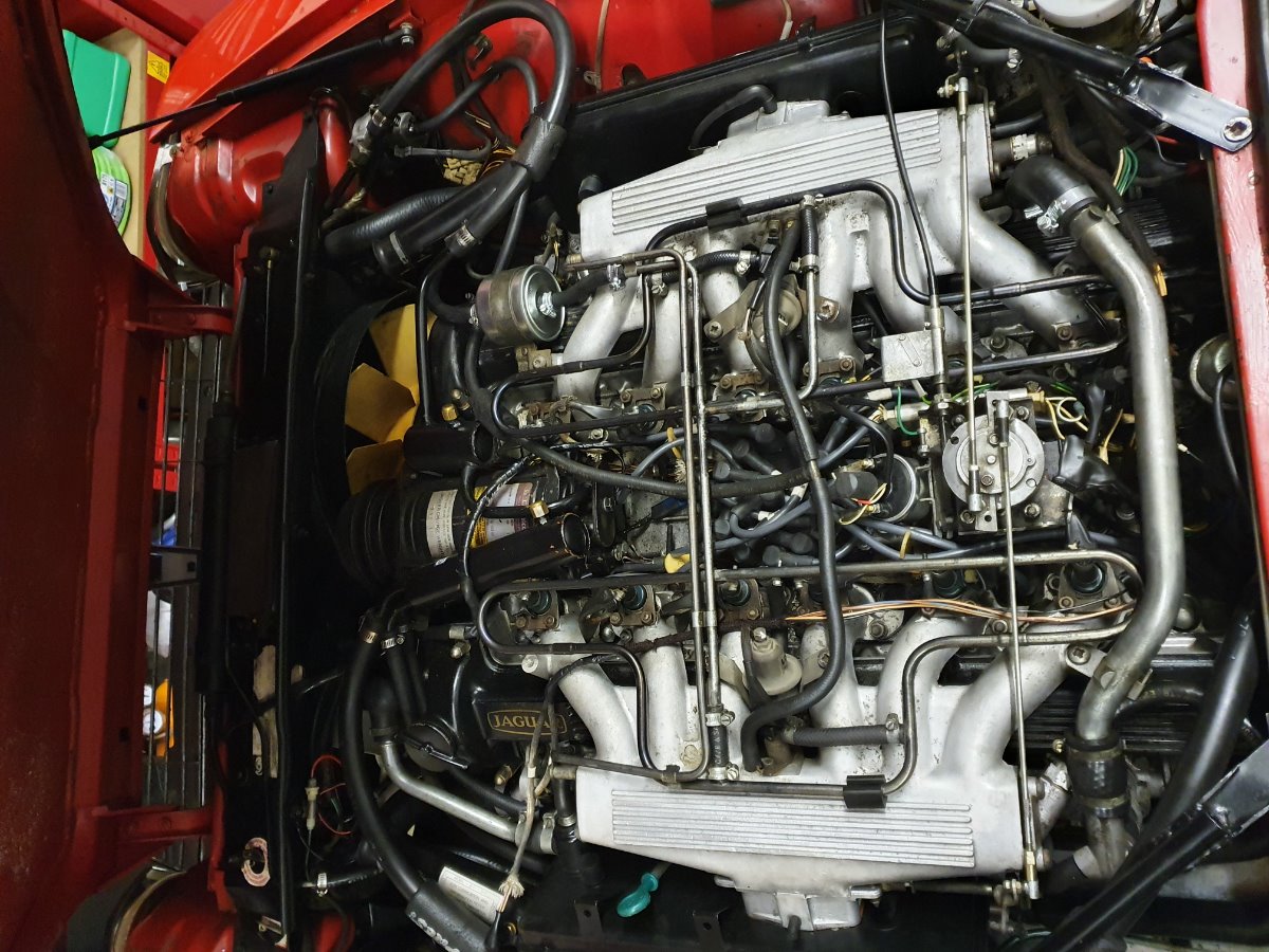

As many of you will know, when you look at the engine bay of an injection V12, it's really quite daunting:

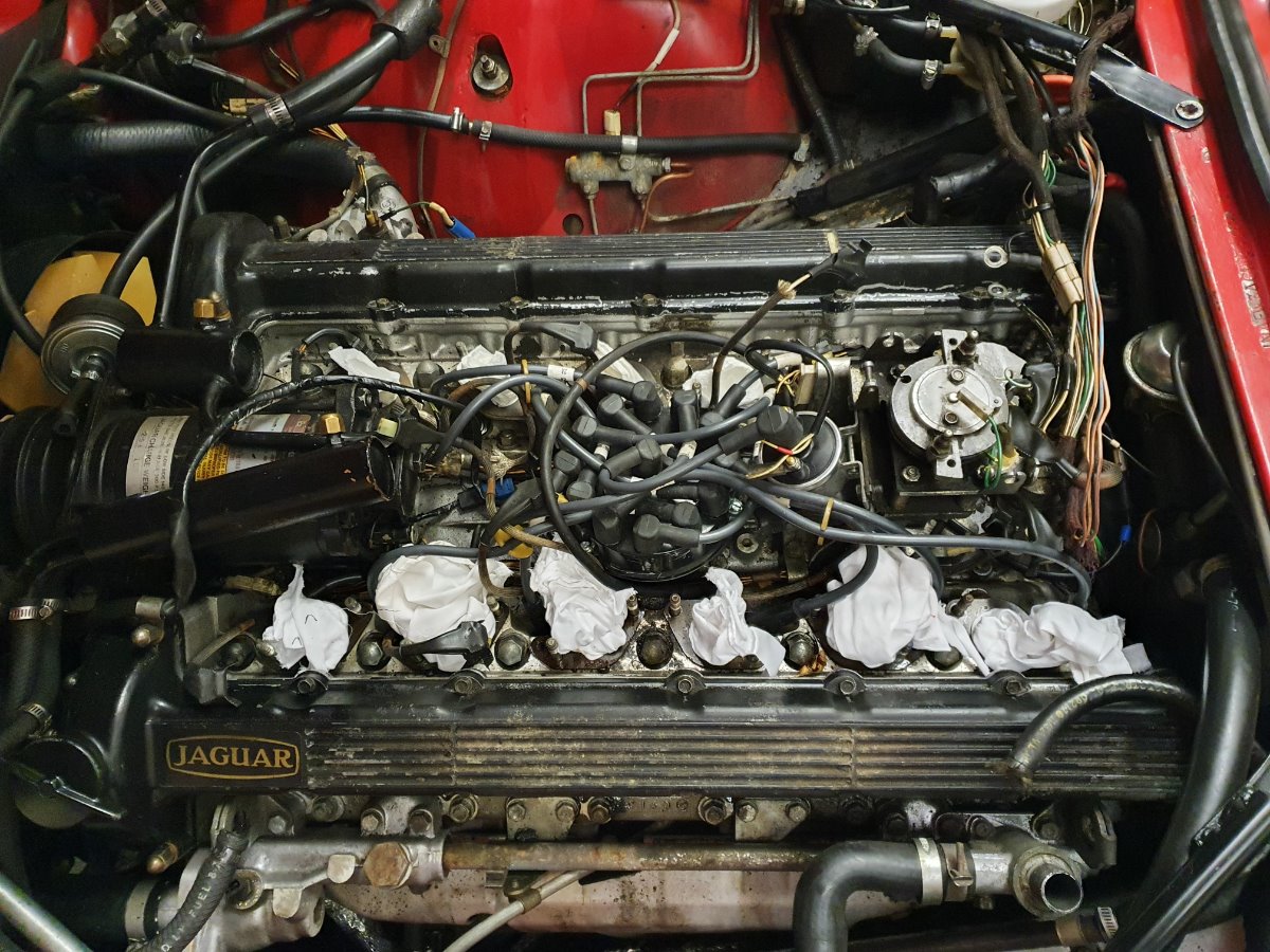

I've started the job and have got the coolant drained and one side of the injection system removed. It's quite a complex and time-consuming job. I'm keeping a very detailed log of every single step to strip it down, which I'll publish at the end.
So as at today, I've got to this point:

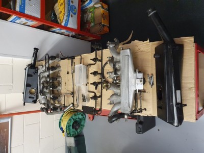

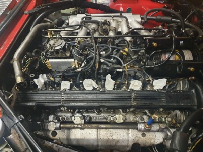

I had dismantled the A-Bank by removing the fuel rail and injectors and then subsequently the inlet manifold. I then decided that I might try and do the B-bank as one unit.
With the fuel injector wiring disconnected and the pipe connections to the AAV and the large vacuum connection pipe on the rear of the manifold removed , I then set to with the inlet manifold nuts and washers. It needed very careful use of my magnetic stick to avoid the nuts and washers falling into the V, but I managed to get them all out. Then with a bit of wiggling, off it all came!
I do like the idea of re-assembling each of the refurbished sides on the bench and then installing as complete units, but access to those manifold nuts is VERY limited when all the fuel rails and injectors are in place. One to consider over the coming weeks.
When you see the engine without its complex fuel intake arrangement, that V12 really is a beautiful sight, isn't it?
The next step will be to remove the radiator and all coolant hoses.
