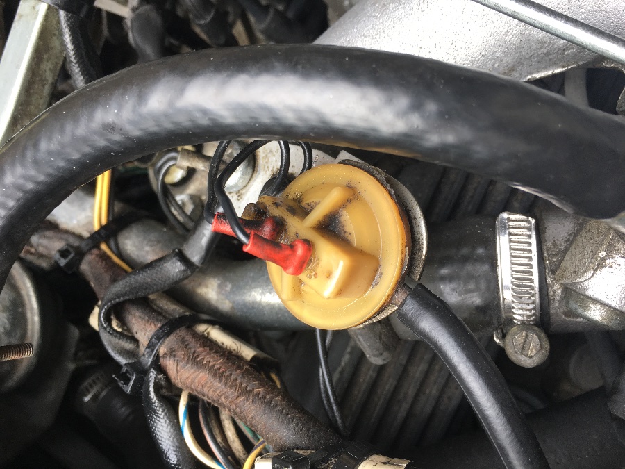

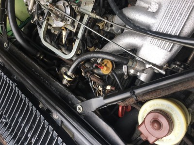

I've had my engine bay cleaned and this mystery part suffered a bit of damage. I'd like to replace it but I've no idea what it is or what it does! Any advices mutely appreciated.
First photo wide so you can see where it is located: (1983 HE)
Close up of part - the yellowy looking round thing with two wires coming off it:
What is this?

It's the full load enrichment switch. It detects from manifold vacuum when the throttles are wide open and sends a signal to the ecu to widen the injector pulses so enriching the mixture.

Many thanks. I think one of the connectors is totally shot. Is it a vital part or am I ok to drive the car given that it probably doesn't function at all at the moment?

It's not vital but is there to give you full power when you floor it. If that's not your usual driving style then that's not an issue!
However, I would advise repairing it so that your car is not running lean at full throttle.
