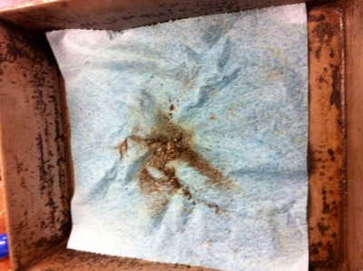

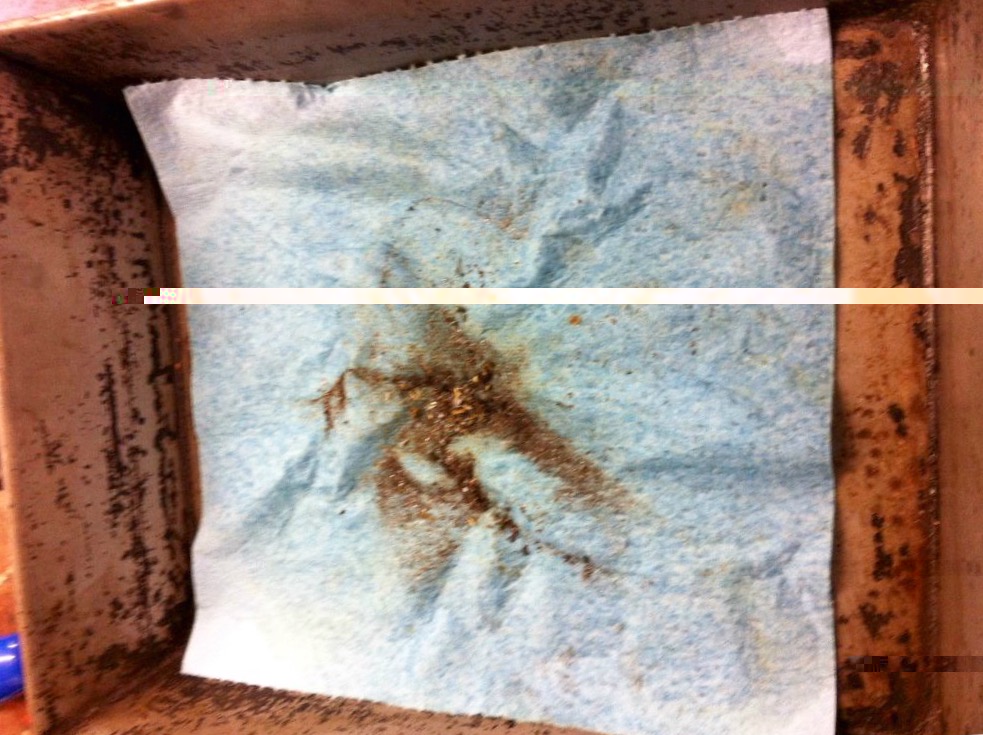

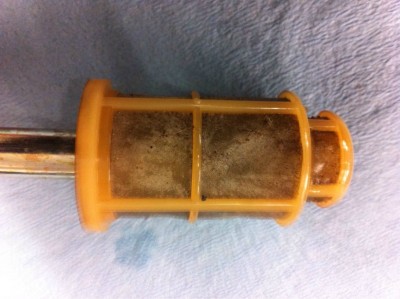

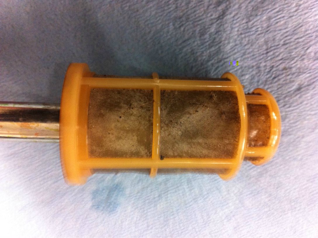

Hi Paul - coolant temperature is one of the major inputs to the ecu controlling the fuel injection system. If it thinks the engine is cold it will increase fuel flow which may account for the car starting fine from cold but then not going well warm. However several things make me wonder whether that is actually your problem. First I think the sender for the instrument pack is a separate one to that for the fuel injection? Secondly I'm not sure that it would give you the symptoms you have and thirdly if the temperature sensor was seriously under reading it would make the car very hard to start when hot.
My best still guess is still either crud in the swirl pot being picked up whilst running and clogging the filter or the coil breaking down under heat.
The crud clogging the fuel filter in the swirl pot builds up as you run the car and gradually starves the fuel supply but will fall off again once you stop, turn off the fuel pump and remove the suction holding it to the filter. You may well take this filter out and think it doesn't look too bad but unless you've taken the swirl pot out and given it a good clean you won't have dealt with the issue.
Here's a picture of the crap that came out of my V12. And the filter Coils are also known to break down under heat so it will be interesting to see if that solves the problem.
David
