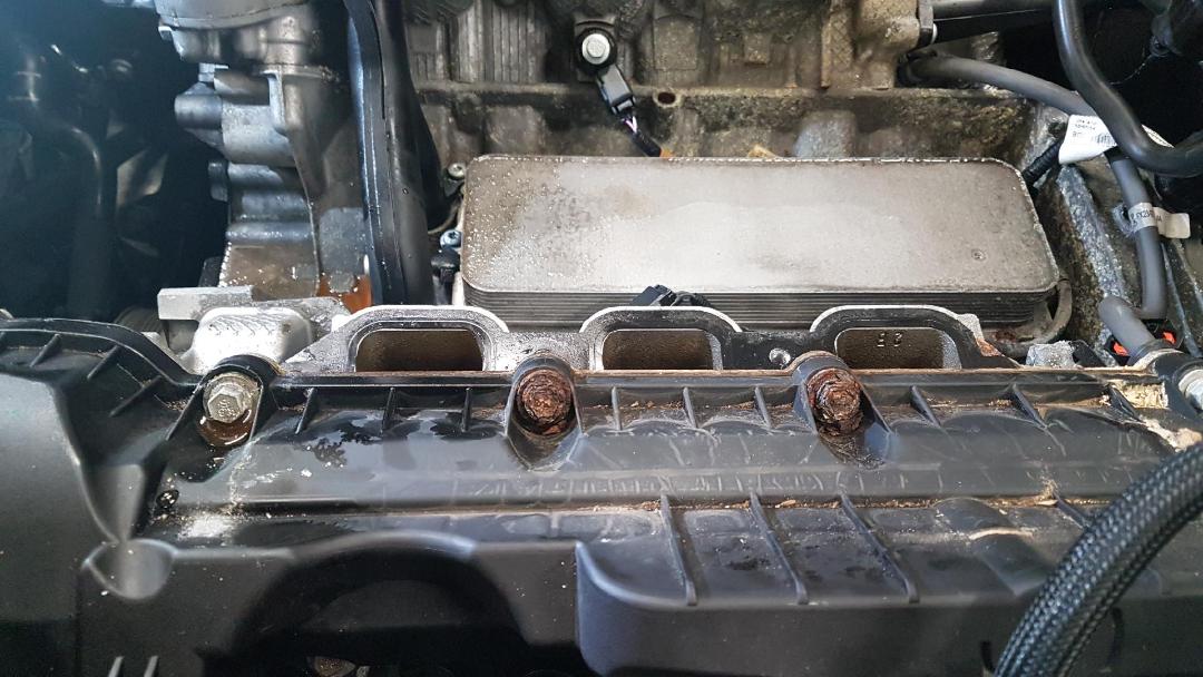

I have attached 2 images of the corrosion I am experiencing with my 3yr old F-Type (obviously just out of warranty).
It was triggered by one of the fuel injectors failing, as they were initially unable to remove the faulty injector due to its condition it had rusted into the housing, they then had drill it out and remove part of the cylinder head to do so. (this was performed by an independent specialist)
I have since been in discussion with JLR who are going to replace some of the damaged parts. Although they have yet to discover the cause, so my worry is is this going to happen in another years time?

Quite difficult to say from the photos but those bolts look to have disintegrated. It looks like it has been through sea water or regularly parked on a sea front road. Have you owned it long, surely you wouldn't have bought it in that condition.

I have owned it from new, I live nowhere near the coast so doubt it is related to salt water. All other areas are clear of rust.
The local independent garage suggested it might be to do with the location of the air inlets on the bonnet allowing the water to fall on to the engine and if it doesn't clear then that could cause it. But that would be a significant design flaw

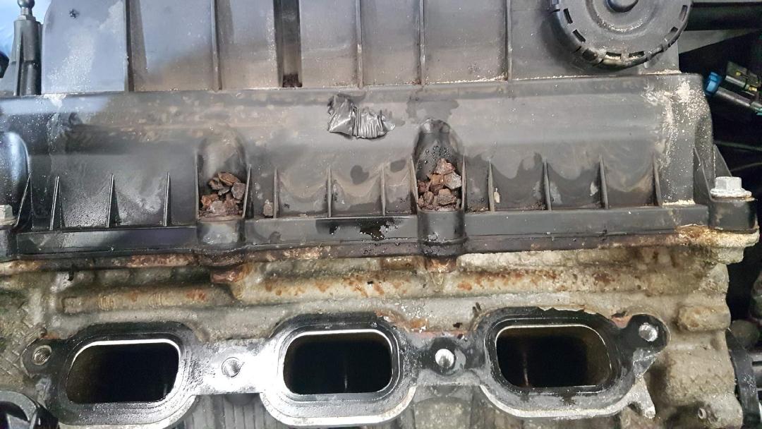

The second picture shows what appears to be an oval "washed" area centred around what appears to be a break in the rocker box cover (? the dark bit held down by the remnants of the bolts in question). There's a tide-mark that starts by the left-most bolt, and rises towards the centre of the round thing on the right. (You can tell I know nothing of F-types!) I wonder if a flaw in the casting allowed something corrosive, coolant most likely, to spray over the area.
It will probably be either a well-known pattern of dirt blowing over the engine, or something to do with cleaning the area for inspection, but maybe there's something more going on.
