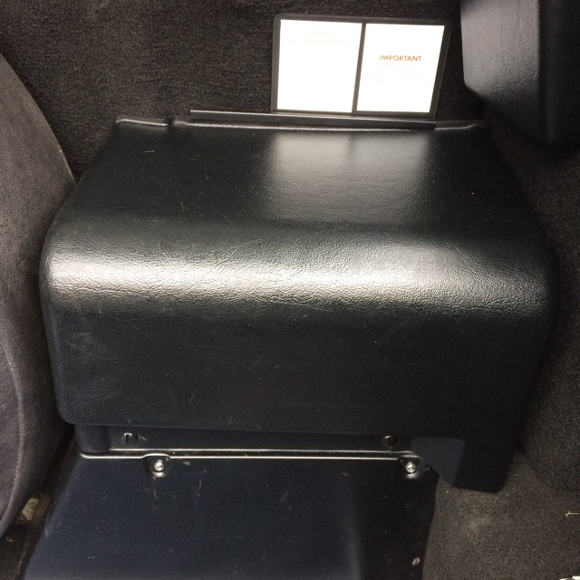

Re: Battery isolator
right,
problem sorted
i bought the clamp as listed earlier by new2jags, and fitted it today
simplicity its self

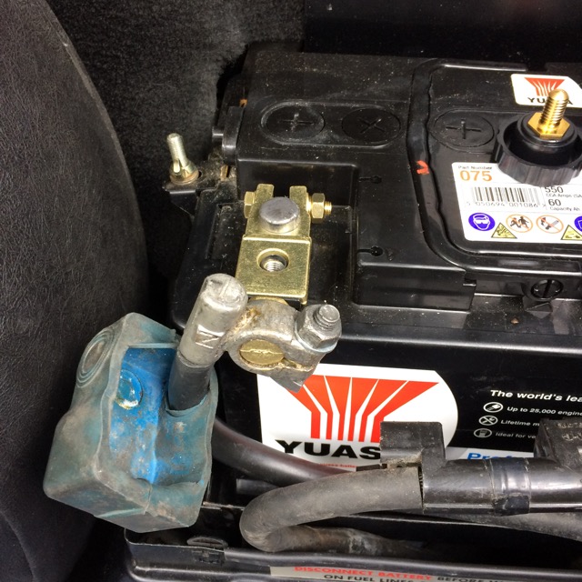

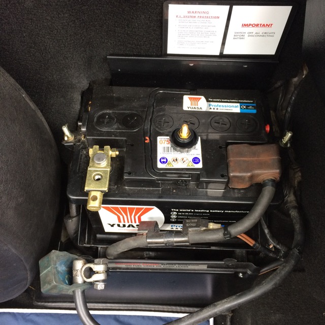

first remove the negative clamp from the battery
then bolt on the new isolator clamp , this is shown with the terminal screw removed and its tightened to the battery with the supplied 7/16 bolt
IMG_2375 by MyPix on Talk Photography
then i rerouted the negative cable behind the positive and fitted it to the stump of the isolator
IMG_2376 by MyPix on Talk Photography

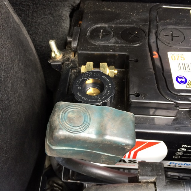

then i put on the original negative terminal cover, and screwed down the new isolator to make the battery connected
IMG_2377 by MyPix on Talk Photography
and then fitted the original unmodified battery cover
IMG_2378 by MyPix on Talk Photography
and the project is completed
IMG_2379 by MyPix on Talk Photography
so , when the car is going to be laid up for more than a few weeks, the isolator screw can be undone, and the battery won't drain
