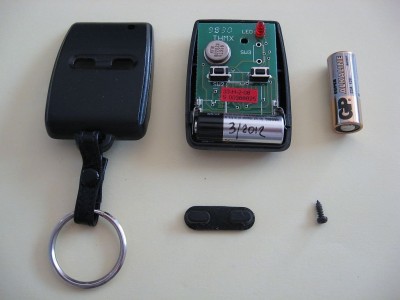

It will be like this when opened,
12v battery.
12v battery.
