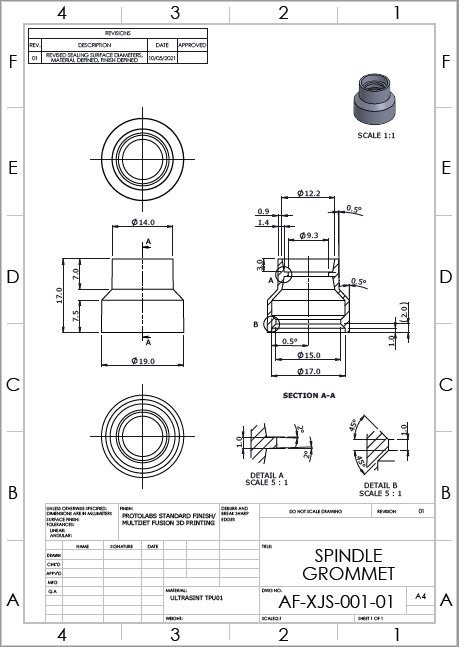

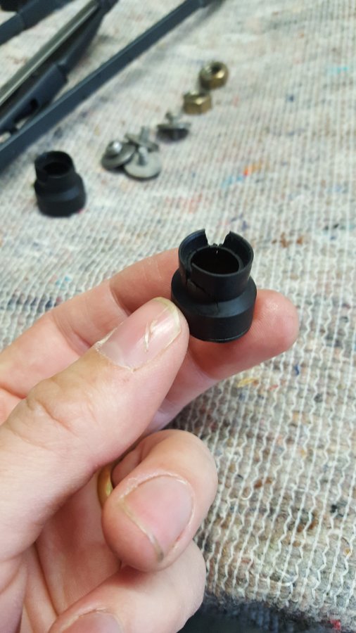

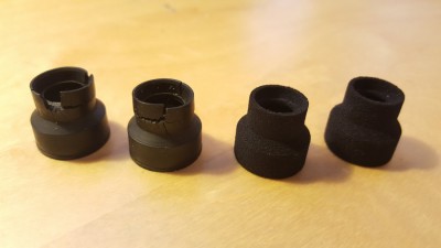

Hello all,
Please see the image below
I am rather excited about this!!! Having found that I could not source replacement wiper mechanism grommets, I set about the task of re-engineering them, using my 17 odd years of experience with engineering Body and Trim systems at Bentley, combined with the latest 3D printing technology.
I reverse engineered the original 27 year old rubber parts and created a set of master drawings and associated 3D CAD.
Using this as the basis, I have tweaked the design to work with 3D printing technology and have had set of 4 prototypes made. I will make some initial trials for form, fit and function and I already can see some areas where they can be improved further.
The turn around for the process of developing these parts - from idea to 1st prototype arriving in my hand - has taken only 20 days, 6 of these were adjusting the design and trialling some different ideas before committing to a final concept.
I'll let you know how the form, fit and function trials go.

Well done Andy - I'll be interested to see how this turns out.

Great stuff Andy!
Would you like a list of other unavailable small rubber and plastic parts for the XJS as your next challenge?!

Thanks Paul
Before I get too excited, I need to be happy with the function of the part etc.
But yes, if you, or anyone else has a "wish list" of parts that either JLR or the current supplier base can't do, let me know!

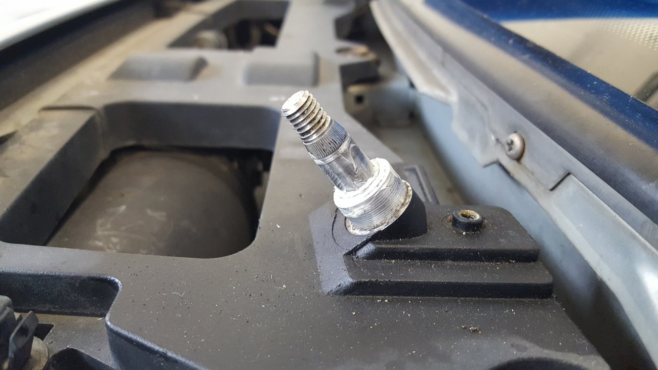

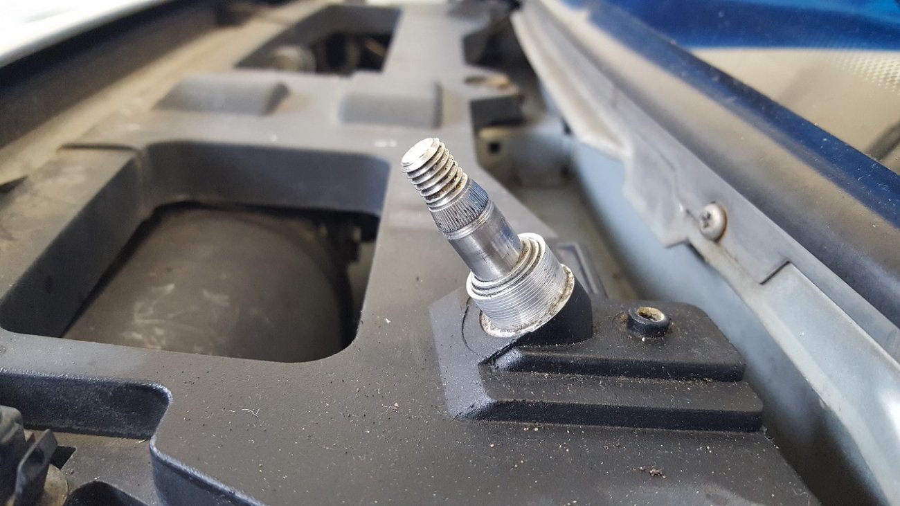

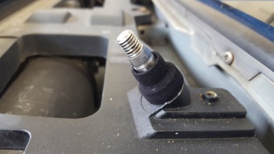

Hi all,
Some progress this afternoon.
I have checked the parts over in detail and I can see a few areas where they can be improved - but overall, they are it for purpose. So - form OK.
I then set about a trial fit on my car - see the sequence of images below:
Cleaned and degreased wiper spindle
Small smear of teflon grease to seal and ease fitment of new grommet
Grommet partially fitted....
Continued...
Continued...

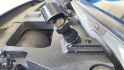

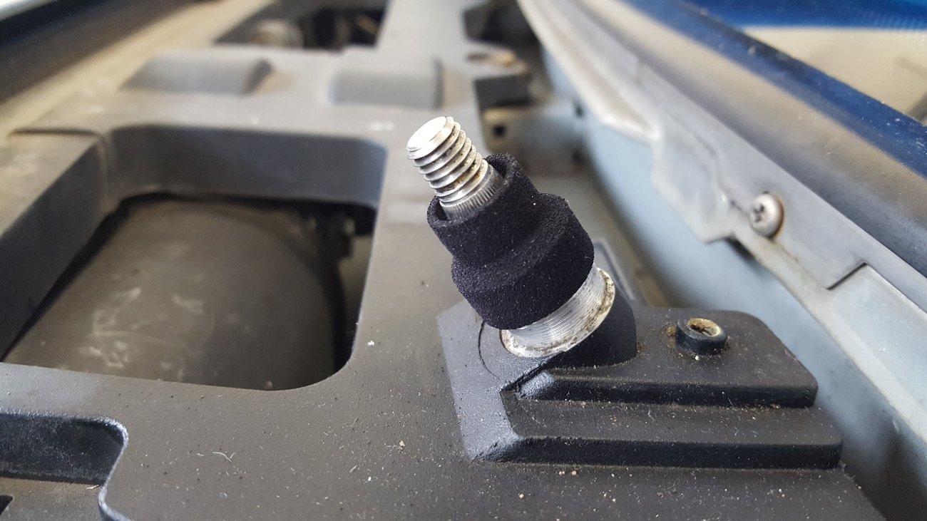

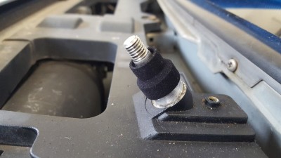

Continued
Grommet seated in position
I then ran the wipers and the spindle turned freely, with the grommet secure in place. Visually, the sealing feature around the wiper spindle appears to be sitting evenly on the surface of the spindle.
With wiper arm now attached
Underside view of wiper - showing small clearance to underside of wiper arm boss, as intended.
So for me, that is a major tick in the "fit" assessment box, with almost the "function" element signed off too. I need to finish the assembly of both arms (once I have the HVAC issue sorted - the reason that all this started!) and then spray the wiper mechanism with water and then disassemble to check for water ingress... but either way, they will be much better at keeping out water and dirt than the original cracked and broken ones.
On reflection, this has been very worthwhile. While the wipers on my XJS don't get a huge amount of use (as it is only used in the dry normally), the fact that the grommets were broken and letting in dirt and water into the wiper mechanism bearings wasn't a good position to be in for the long term. This is massively amplified by the fact that wiper mechanisms, certainly for the facelift, are NLA as new assemblies. So, for a small outlay, mine are now protected from the elements.
I hope you have enjoyed following this with me. Roll on the next project....

Really good, Andy! Well done!
And the price to loyal upstanding JEC members will be...?
Naive question perhaps, but are you limited as to the material composition and colours of what you can produce?

Hi Paul,
Material composition has some constraints - traditional 3D printing tended to have a very narrow range of materials available, with limited mechanical properties. With the advances seen in the last 10 - 15 years, it is now possible to print in a range of metals, plastics and rubbers, with much higher integrity and confidence in their mechanical properties. What really gets me excited is linking 3D printing with multi-parametric finite element modelling, which gives rise to beautiful lightweight organic shapes that simply could not be made using conventional processes... but this is all bit beyond what we are considering here (my old life coming back to haunt me!)....
For these grommets, I first looked at getting them made as a traditional injection moulding, but the tooling cost (for conventional metallic tooling) didn't make sense at the volumes I wanted (I only wanted a few!). Focus then swung to 3D printing, where improvements in process now allows printing in flexible materials, suitable for grommets, seals etc. These first prototype parts are made from a type of polyurethane so have similar feel / stiffness to the original parts. As the base material is naturally black, hence the parts come out black. However, dye can be added for moulded parts or post printing painting can modify the original colour to anything that is needed.
As regards prices... I can make some more - please PM me with your details if you are interested and I am sure we can come to some agreement!
