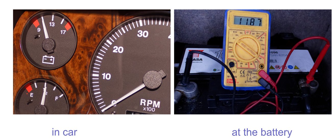

This morning I went and checked again. At switch on the gauge indicated barely 11 v while a meter on the battery said almost 12v.

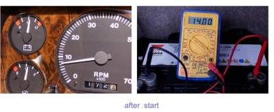

At idle after start the in-car gauge is just over 13 v while a meter at the battery says 14 v. Almost a volt down in both cases.
So, anyone any thoughts on where the missing volt(s) might have gone? High resistance earth connection for the instrument cluster, possibly? Where would one look for that I wonder?
All thoughts welcome.
