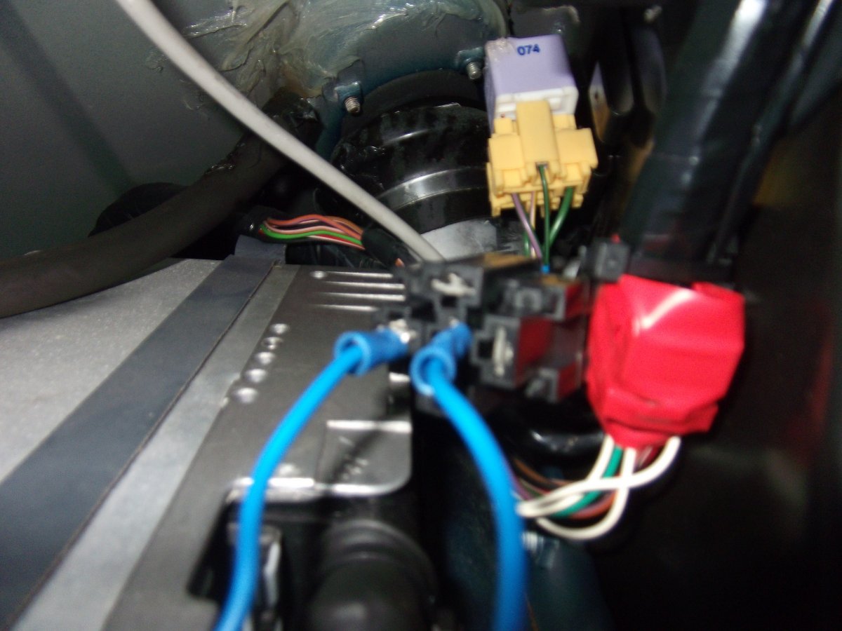

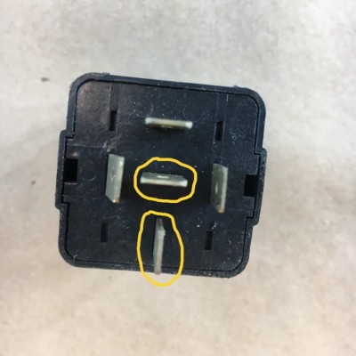

Re: Erratic Fuel guage
Peter,
If you remove the module to test it, you need to bridge the terminals on the holder that correspond to the pins of the module as detailed in the pic below:
The wire colours on the holder that you need to bridge are the light green wire terminal (which is the voltage input feed from the tank sensor) and the brown/ pink wire terminal (which is the output voltage feed to the instrument gauge). I made up a wire with a spade connector on each end and just inserted it in the holder as shown below (forgive the blurred image):
Hope this helps
Hope this helps
