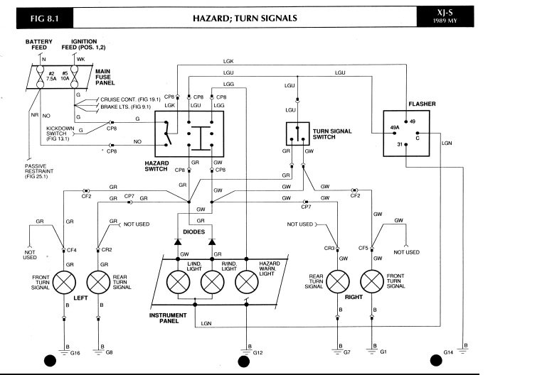

First, I have no personal experience of the XJS models, however, I noted this post and as I have access to the relevant wiring diagram, here it is for what it's worth. There certainly doesn't seem to be any commonality between the left and righthand sides, though the effect of a problem with either or both those diodes might be interesting. What are the dash indicator lights doing?
I'd hope it's a coincidental failure of both rear bulbs, though I thought bulb failure was always (deliberately) accompanied by rapid flashing of the remaining bulbs?

Postby paulfrost88960 » Sat Apr 23, 2022 4:34 pm
I think i may have mentioned my self repairing XJ-S before well it's done it again! Went out to the garage to check earths again, but before i did thought i would just check if the indicators were working and sure enough all ok now! I can only think that it was an earth problem that too overnight to sort itself out after i'd tightened them last night.........doesn't seem likely so i'll go with self repairing, at least that should be a good selling point if i ever want to move it on!
