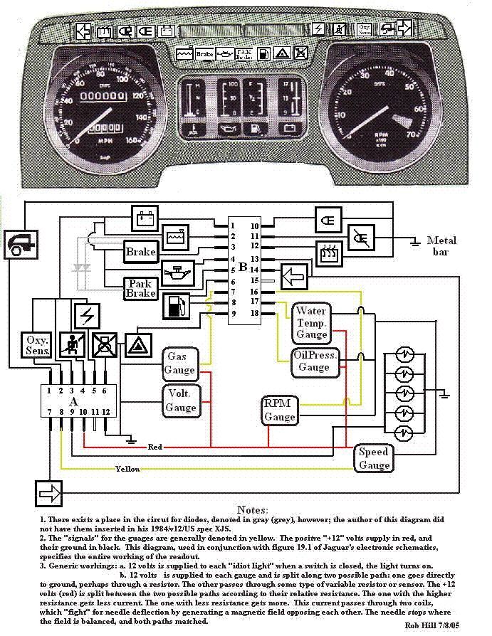

I came across this diagram which may be of use to others needing information or if the problem should come back.
