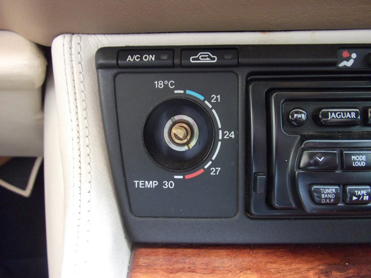

As many of you will have installed audio equipment in XJSs, you'll know that the installation is fairly simple. I started by removing the aircon control panel knobs and the retaining nuts behind:

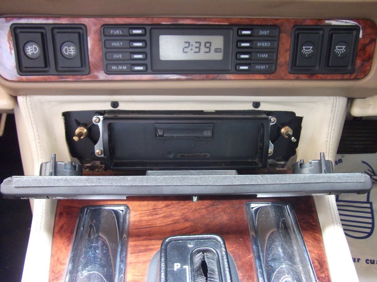

I then removed the aircon panel with a bit of gentle persuasion! You can then see the four mounting screws for the old unit (face panel removed to prevent any damage)

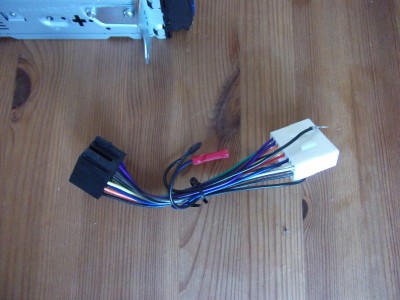

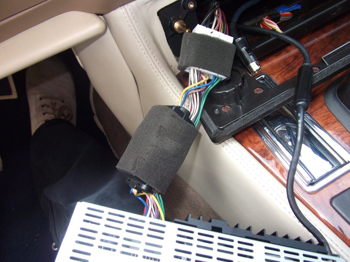

With the old unit out and unplugged, you can see the Jaguar-specific wiring plug. This is the only minor inconvenience. I found an adapter plug on ebay for the princely sum of £4.99. This converts the Jaguar-specific interface into a standard ISO interface plug.

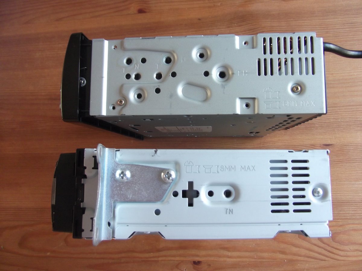

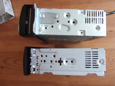

The old Alpine unit was fitted to the car with 2 side brackets. I don't know if this an industry standard fitment, but when I removed the typical slide cage from the new unit, you can see how the brackets were able to be perfectly swapped over to the new Alpine unit.

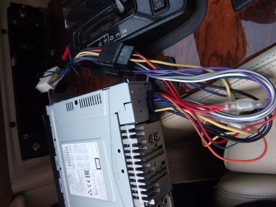

You can see how the wiring adapter just plugs into the wiring loom of the new unit enabling it now to be fitted to the Jaguar wiring plug in the car
With the unit quickly plugged into the car, it was nearly time to do a test.

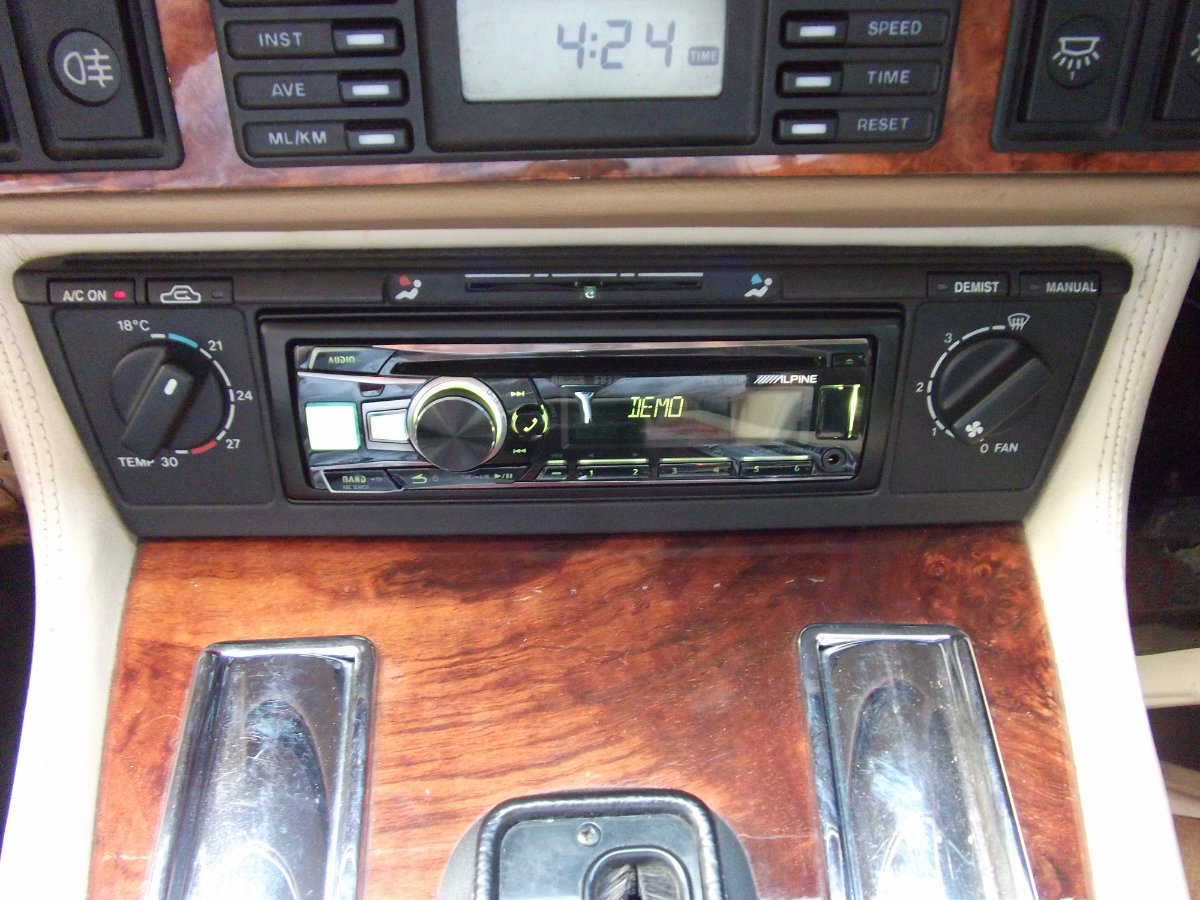

The unit powered up immediately and was quickly tuned in to a radio station to check sound output. The unit has a 4x50w amp so I was keen to see if the existing speakers would function ok without distortion. Fortunately, it sounds great!
I then paired my phone (an HTC One M8 which is a great phone!) and checked the Bluetooth connection and music streaming capability

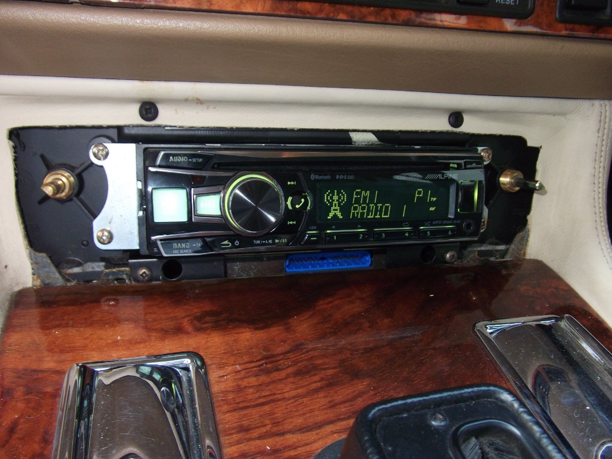

With the unit seeming to work fine, I then fitted it into the old mounting points
The aircon panel was fitted back in place, the most difficult bit trying to ease the wiring plug back into its socket.

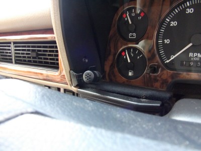

I had already removed the instrument surrounds and drivers cheek panel and threaded the phone microphone wire through. I was going to route it up to the sunvisor, but decided that it worked much better and was less obtrusive if I mounted it on the side of the instrument cluster. Yes, I have fettled the trim back into place properly since!
