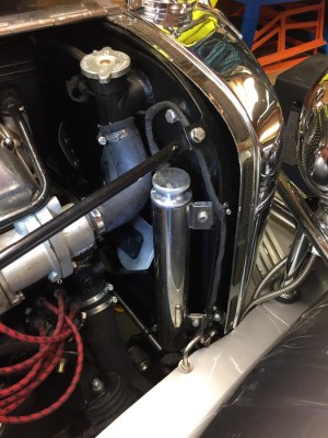

The same expansion tank is on Ratsport.com where there is rather more detail and prices. I contacted Pop Browns re details and prices but no reply as yet. I’m planning to go ahead with the 15” version fitted to the offside radiator hoop where there is more room.

A quick follow up on the stainless steel expansion tanks being discussed, I’ve ordered mine from Pop Browns as they were almost half the cost of Ratsport.com Over £35 cheaper.
Re: SS100 Overheating
I’ve now done 500 miles without any issues. Only recently has weather been hot enough to cause problems previously encountered but no water has needed to be added every time I’ve checked. Hearside of Engine did not offer enough room so I ran the overflow pipe through a tubular carrier on the chassis cross member.

I seem to have managed to lose the photo or the expansion tank I’ve fitted which would make rather more sense of the script. Watch this space!,
