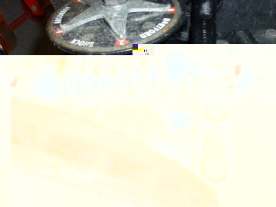

This is the procedure I used to remove and check the suspension unit bushes. Looking at the wear I will now replace the bushes every 5000 miles. My procedure follows the build sequence I used building my car.
Jack up the car and support on blocks or axle stands.
Remove the road wheel.
Wind out any suspension ride height adjustment, this removes any tension on the spring
Undo the suspension top bolt and withdraw it, taking car not to loose the spacers
Undo the support plate from the lower wishbone, Drop the plate and then undo the lower suspension bolt.
Push out the bush centres and then the poly bushes.
To replace them, heat the new bushes in boiling water and push in. They are stiff but fairly indestructible.
Connect the suspension unit to the bottom plate. The damper dial faces inwards. Torque the lower bolt to 50ftLb
Offer up the lower plate to the wishbone and bolt in.
Lift the lower wishbone using a small jack and bolt in the upper bolt remembering the spacers (50ftlB)
Wind in the height adjustment, (I have 12 turns at the front, for more detail about ride height, see separate thread)
Replace the wheel.

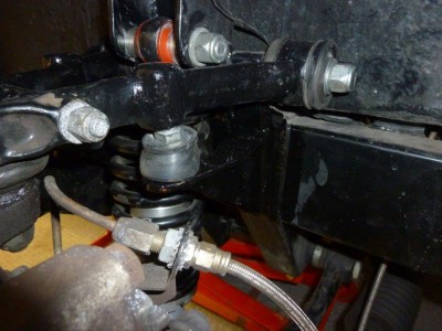

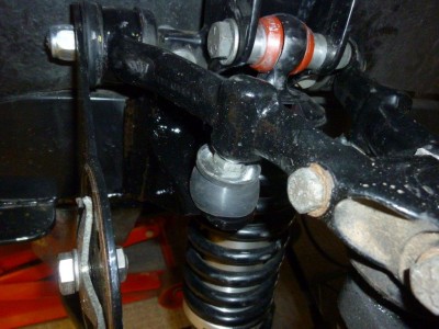

John let me know immediately he discovered his problem with his front coil overs so I checked mine at 14k miles and found that although not as bad as John's the bushes were shot (not quite through to the metal) and the shockers were worn and leaking.
I have a very good classic car repair/refurb company near me called Moorland Classics (North Staffs- Details available if you leave me a message) I visited Moorland Classics and they came up with the bump stops on the attached photos
The rubber buffers are from a MK2 and fit to the upper wishbone.
The tricky part (which was beyond me) MC made up two stop brackets on each side welded to the chassis which the rubber bump stops hit and stop the coil overs bottoming.
My Suffolk has done over 17k miles and no sign of wear/oil leaks on the shocks and there does not appear to be any wear on the bushes but will check them further in the spring pre MOT, will let you know then!
