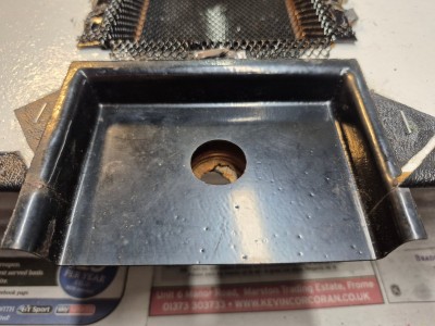

I am refitting my Rear Parcel Shelf after 20 years and have lost all of my photos (and my memory) ... the two outer bolts that secure the parcel shelf are obvious, but the centre bolt, any spacers and the thin plastic rectangular object underneath - this is a mystery that is not covered in any parts manual that I have seen.
So, underneath the parcel shelf (centrally) and to the rear of the raised wooden and vinyl covered air circulation part, there is a thin plastic rectangular part similar to the lid of a box but with one end missing and with a hole for a bolt ... this plastic bit doesn't attach to the parcel shelf but could slide into the space under the raised air circulation bit - also, it looks as though it should bolt to the body of the car (under the parcel shelf). In addition, there must be a (missing) spacer of some description to fill the gap between car body and the underside of the parcel shelf?

However, with a bit thought, it becomes obvious because the plastic bit will only fit and align with the bolt-hole in one orientation ... the spacer (missing) could potentially be substituted with a piece of coolant hose of the correct diameter and cut to the right length?

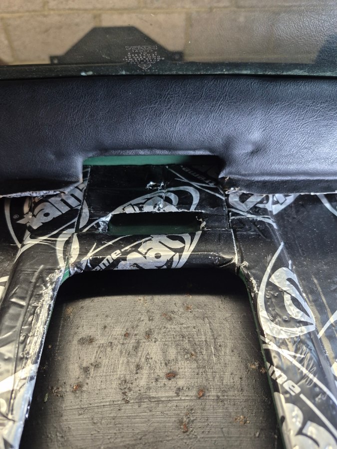

Nevertheless, you suggested that some pictures might prove useful ... attached as follows:

I cannot identify BD48277/1 plus I cannot see 'how' it can be a bolt. The hole is not threaded and the rear side is of the hole is chamfered forwards - a bolt would not go into the hole ... it must be something else. Looks like the fitting for a shoe of some description where the toe would fit facing forwards - a bolt (or screw) might then engage into it.

Definitely not a bolt where I am in the process of making a shoe attached to a piece of coolant hose (of correct length) into which I can then insert one of those plastic fir-tree type fasteners to hold the rear of the parcel shelf down and in place. A bit Heath-Robinson but it looks as though it will work. Most technical bit will be to get the depth of the coolant hose correct.
