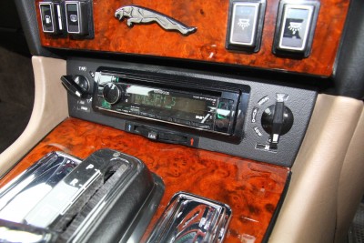

I put a Kenwood radio/CD player in. It’s not the best but it met my needs and I got it at a good price.
The original set has the old fashioned two spindles that fit through the aircon facia panel with a larger cut-out for the tuning section. The newer DIN style sets obviously won’t fit the existing facia so I sourced a new old stock facia plate on ebay and cut out the centre section with a small Dremel circular saw to fit the new radio support cage (being careful not to cut the fibre optics!). I’m keeping the original panel and radio in case someone wants to refit them at some point.

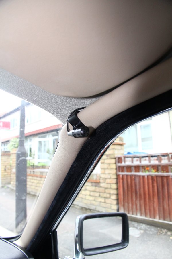

As I said, it’s a very tight fit as the depth of the slot isn’t designed for modern sets. There are a number of wires running in the cavity behind the radio, including a particularly large, long flat earth strap, along with other bits and pieces that get in the way. I removed the centre console side trim panels to try to get access and move cables but that doesn’t give much, if any, access from what I remember but it did allow me to run the microphone cable through. With a lot of fiddling and pushing bits and pieces back and into the aperture corners as far as possible, I just about managed to squeeze it in. I clipped the phone microphone to the top of the cant rail and ran the cable behind the A pillar trim, under the dash and into the back of the centre console by the heating/cooling air box. Rather than alter the original wiring, I disconnected the standard multi pin connectors on the radio and fitted spade and bullet terminals to suit the existing power, speaker and electric aerial wiring.
It would certainly be an easier job with a shorter set! The Kenwood set is 155.5mm deep which is probably pretty standard these days.
The new set came with a DAB aerial that needs to be stuck to the windscreen with an ‘earth sheet’ that needs to be stuck to the metal bodywork. I didn’t want to do any of that so just use the existing aerial for FM and DAB. It mostly works fine but I do lose the DAB signal in weak areas (but then so does my VW T-Roc!).
I didn’t take any photos of the fitting but here’s one of the unit in situ and the microphone placement. You can see the facia panels via the links above. Ray
