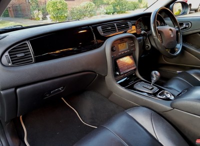

I thought I would share these picture with you of the refurbished interior of my S-Type.
I bought a complete second hand set of used interior panels on Ebay for £30 and sent them away to be painted and lacquered in "Grand Piano Black"
I think this brings the interior a bit more up to date. I kept the old interior in case things didn't work out, but as you can see, it works rather well i think.
Cost: Panels £30 on Ebay. £275 to spray and lacquer and £150 to have it all swapped over. Obviously this would be a much cheaper job if you DIY. but it is amazing what a bit of paint can do! :-)
Les Adams

Wider shot to show full effect....

Hi Ladams Is there any veneer effect on this trim now or is it just black.
Jeff
Previous Jaguars.
1967 3.8 S Type.
Series 1 XJ 4.2
Series 2 XJ 4.2
Ladams
Posts:57
Joined:Tue Apr 18, 2017 1:06 pm
Re: New "Grand Piano Black" for my S-Type
Postby Ladams » Thu Jul 06, 2017 1:42 pm
Hi Jeff,
No, all the wood has been replaced by Black.
I bought a standard set of panels second hand on Ebay and sent them to "Trim-Star" in Colchester. They manly do Bentley and Rang Rover custom interiors and their work is to a very high standard.
They rubbed them down and prepared them, then sprayed them black and applied several coats of lacquer. The results are stunning. They have a very deep black shine like wood and are very easily wiped clean with a microfiber cloth. No veneer involved. They can do all different finishes including carbon fibre for which they use a process called hydro-dipping. But for Grand Piano Black it is just paint and lacquer.
