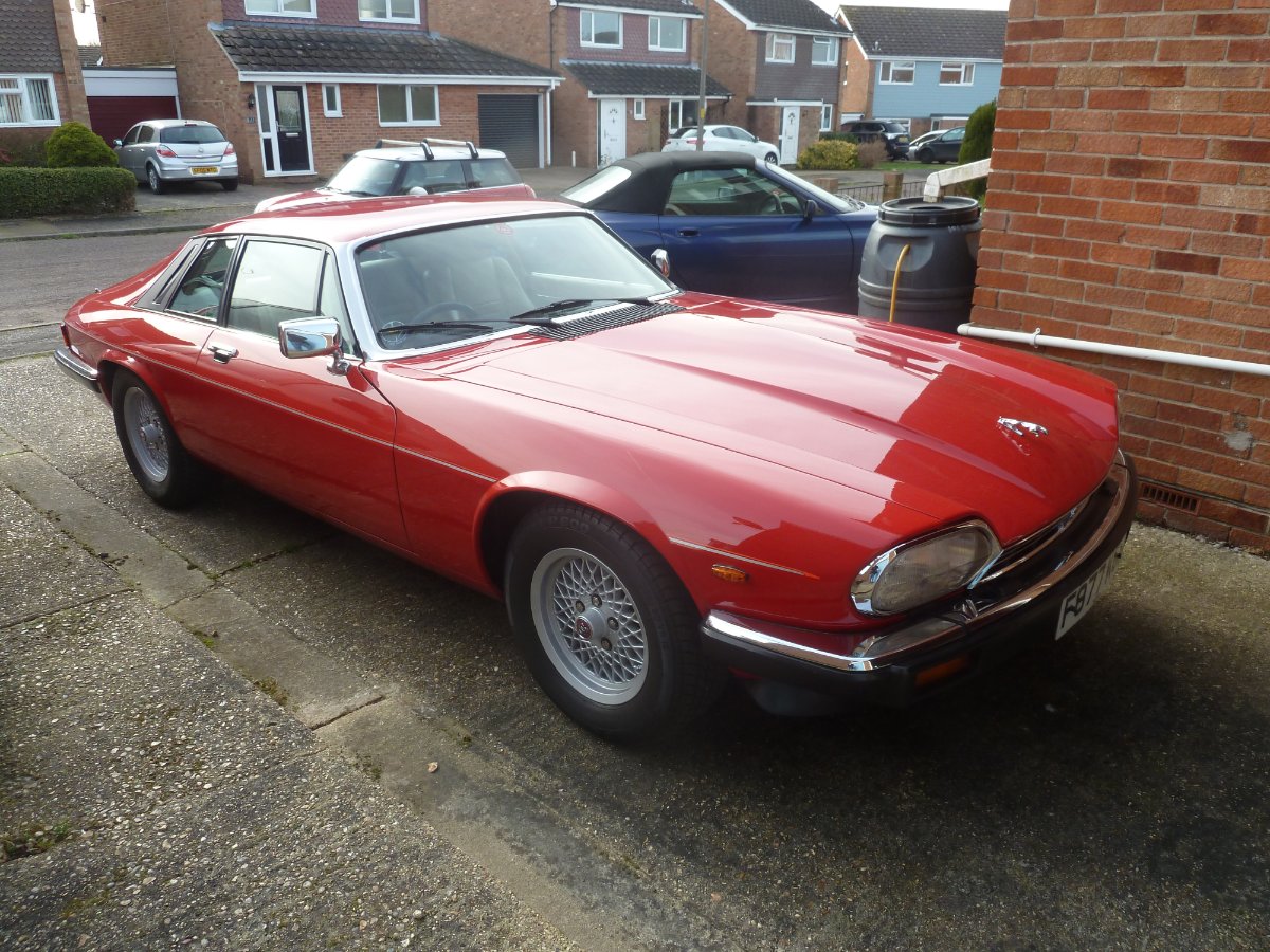

Hi again all. I've now picked my car up in a gap between storms and it's tucked up in the garage for now. I think it's fantastic and If i can work out how to attach some photos i will do that in a minute. There as expected a few little niggles to sort through when it stops raining and perhaps you can give me some advice?
