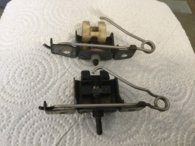

Hi,
After months of searching I recently was able to purchase some really good examples of these headlight adjusters. The only difference I can see between the 2 types is the shape of tension spring, so if anyone wants to see mine I will try and download photos.
Re: pre facelift headlight mountings
From this photo you can see the difference between the 2 headlight adjusters. You will see one component is black and one is white but I think this maybe early and late versions of material used. The other obvious difference is the. Shape of the spring. The one with the black component is the single adjuster that is fitted below the headlight the white one is one of two that fits either side of the headlight. I hope this description is clear

Hi,
As the only difference is the spring, I decided to try and swap it to the other adjuster. This was an easy process so no need to by the correct type but just use the spring off your old unit (only feasible if you have an old one). It looks obvious that the main reason people replace these are not for damaged springs as they are quite robust.
