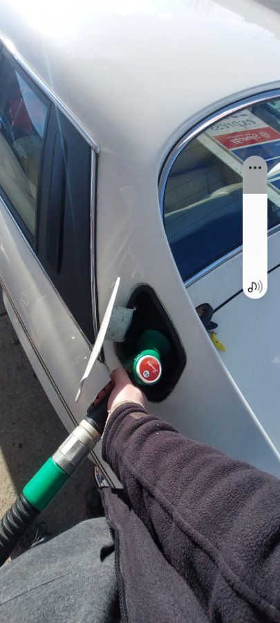

One big expense actually the same as the bosch battery was petrol, the price of E5 super was £1.62 a litre and she likes a drink.

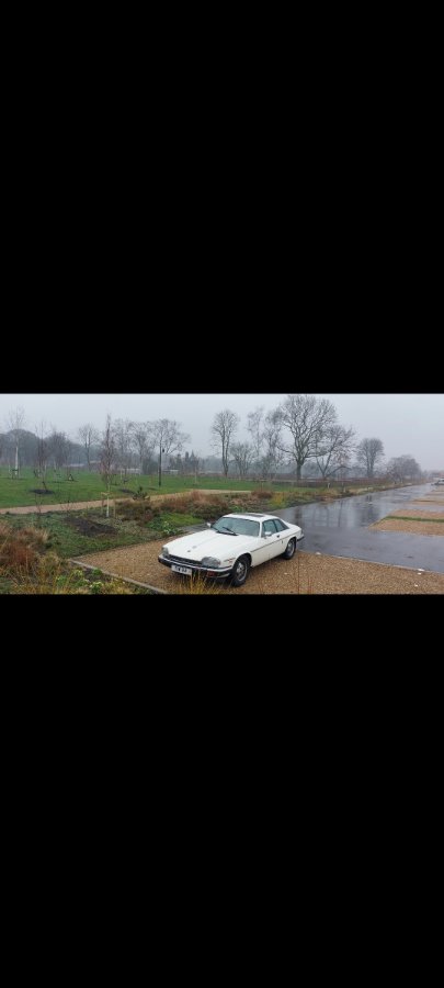

I'm quite local to the new RHS Gardens in Manchester.

Good to see pictures of your car, Lastmin - i really love an XJ-S in white.

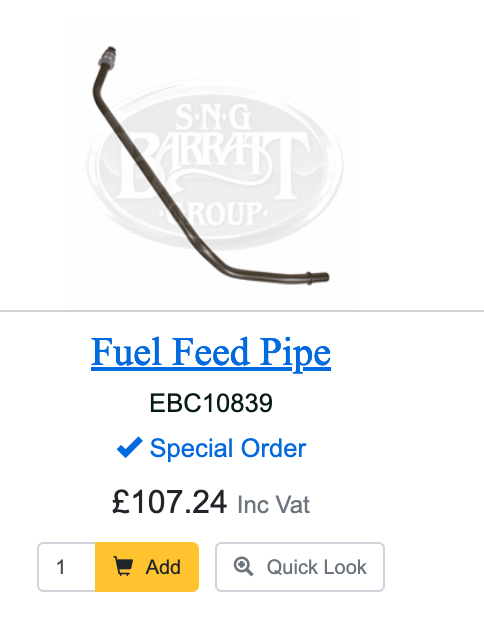

Ironically this just arrived in my email from SNG Barratt - one small part and is the only part I have seen so far - not cheap!!
On this basis, renewing all 3 lengths must be North of £500!!
