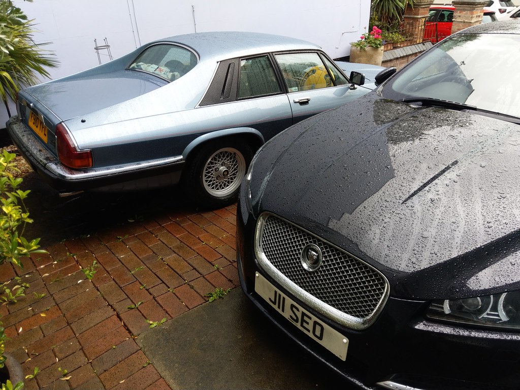

The weather forecast wasn't promising for the following day with rain likely for most of it - and when we woke up, the Jag was soaked. It was in good company though:

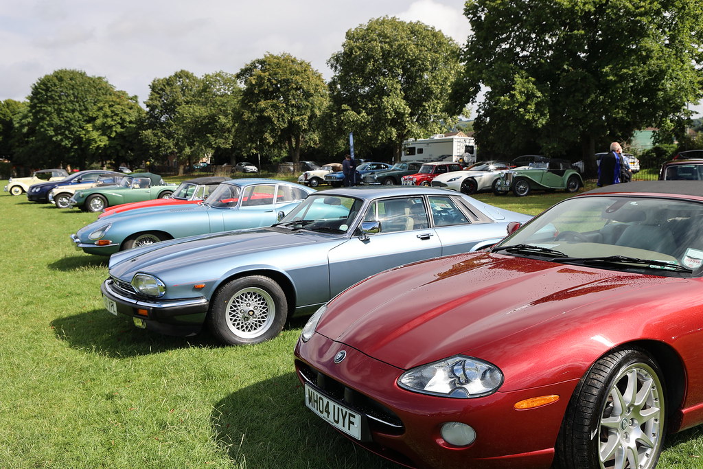

Sadly, the cricket match had to be cancelled due to the weather, but the classic car show went ahead with about half of the participants present. There were cars from the 1930's to the 2000's, and plenty of Jaguars to feast the eye on:
