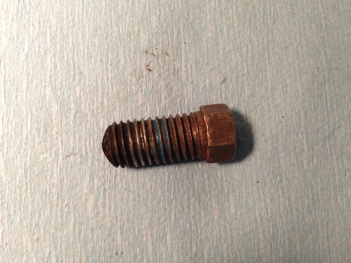

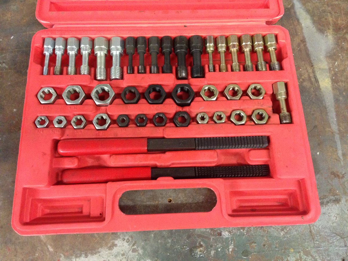

Hi Richard - I have an AAV that I cut up for an autopsy and subsequent magazine article that we published in August 2018. Why? Well if you leave a bloke alone with a disc cutter its inevitable!
Here are the parts that I cut up. I have a thread repair kit which as well as its obvious job is also very useful for working out a mystery thread. This kit is not very expensive and its one of the most useful things in my workshop. The idle screw has a peculiar thread. Its very close to 1/2" UNC but binds up after a few turns. Its closer to M12 x 1.75 but again binds up after a few turns so I'm not sure what it is. So I fear I've not helped you much. Of course ,what I do have is a spare idle screw and you're welcome to that if you send me your address. You can either pm me here or my contact details are in the masthead of the XJS section in the magazine

According to Kirby Palm's book
What's really annoying is I had a broken one I could have measured sitting on the shelf and only threw it out late last year.
On this author’s ’83 (as well as in the photo), the adjuster is a 12mm thread with a head barely larger than the threads, so
the head requires a 13mm socket to fit. However, Craig Sawyers reports that later versions (including replacement
valves to fit earlier cars) use a metric threaded adjuster with a much larger head: “The old one is indeed metric, M12,
but metric fine thread. It is however a special, with a 13mm AF head (standard is 19mm AF). New valve 12mm over
the threads, 1.75mm thread pitch and 19mm AF. That is a standard metric M12 bolt. Truly huge by comparison.
Jag/Lucas have clearly economised by using a standard M12 coarse thread bolt with the standard head. Adjustment
sensitivity with the coarse thread is just fine.”

The pictures I took were today. That screw is sat on my workbench. Yours if you want it.
