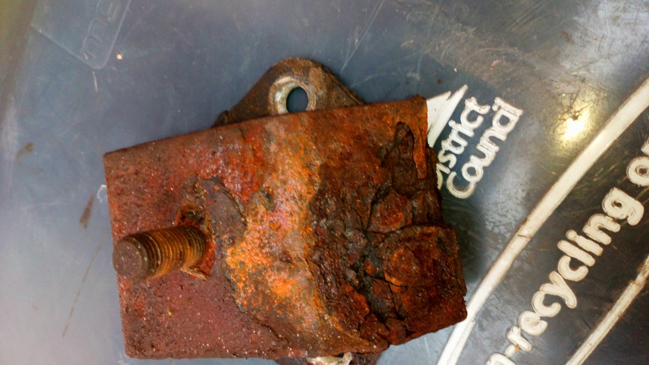

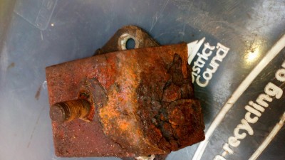

Re: Front end creak / clicking
Many thanks for all of your replies about my annoying noise. I took the plunge and dropped the front sub frame and immediately found the culprit. It was one of the subframe vee bushes. One side of the bush had completely rotted away. So while it was all off, I went and refurbished the whole subframe. I took it out today for a short test drive and all creaking and clicking was gone.
