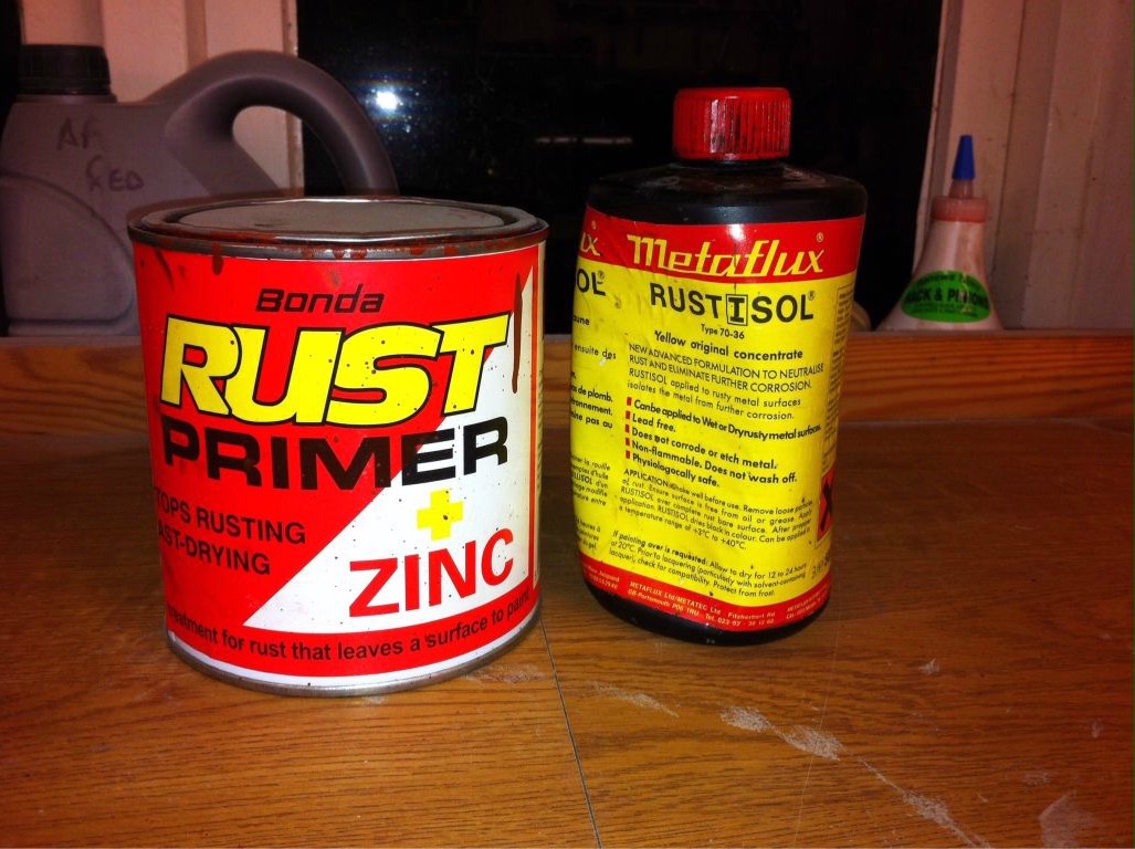

Seb - if you can see surface rust treat is as soon as possible. A good rust cure product and then a coat of primer will keep it at bay until you can get some proper paint on. These are the products I use

I hope you are successful with your rust proofing efforts. My personal ten pence worth experience of using Kurust, and just about ever other rust proofing product on the market, is that the rust always seems to come back. This is usually a few months after one has primed and painted the area to satisfaction and, just as you have got it looking nice again,the rust bubbles break through again. After many years and many and varied cars with rusted bits, I think the only long-term fix is to cut out rusted areas and weld in good new metal.

You really need to sort the rust fully on the top of the scuttle / inner wing and also on the top of the sill directly below that area. As you've sen moisture drops down there, falls to the top of teh sill, accumulates and then also rots out the lower part of the outer wing as has happened on yours. Getting those three panels, fully welded, painted and waxed is critical to keeping the tinworm at bay on an XJS.
