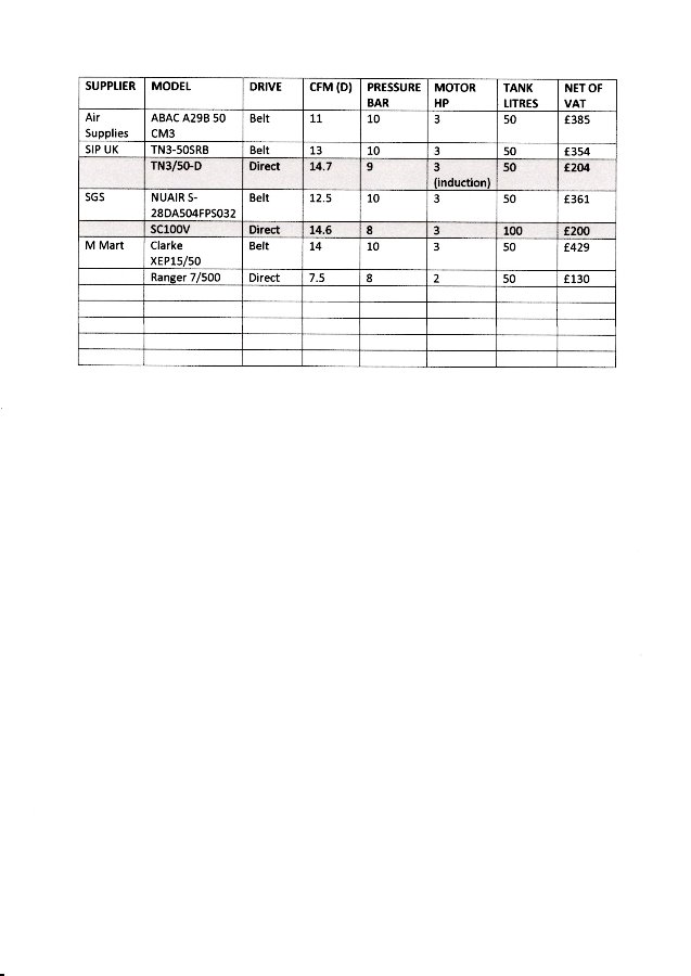

I would love to spend £400 - £500 on a belt drive compressor, but I don't think I would use it enough to justify that range of cost - and then there are the tools to buy in addition. So, I have done some research and attach a table showing models and features etc. I am inclined to go for one of the two highlighted machines (SC100V or TN3/50-D) and am leaning towards the TN3 (from SIP). Why? Because these two tick the essential performance boxes of Pressure, Tank size, Air flow rate, and Motor power and are a reasonable cost.

If you're limited to about £250, I'd buy the SIP TN3 of the ones you've listed. Good price at £204. Cheapest I could see it was £212 delivered.
I THINK that all those figures are Displacement. You really have to get the CFM FAD figure for each model to know what you're buying and how well it will run your tools. There isn't a straight correlation. Poor efficiency models can have a high Displacement figure that does not translate well to a FAD figure. All the booklets or technical spec will state the FAD figures.
Yes, all my figures are displacement but FAD figures are not always published on line or in the product handbooks. I gave up trying to find the FAD figures for Air Supplies and M Mart but called the technical department of SGS for theirs. The SGS SC100V has a FAD of 10.6 CFM and the SIP TN3 10% less at 9.5 CFM. The displacement figures are 14.6 and 14.7 respectively. I reckon either will be OK for my needs, but you are right to make the point Paul and thanks for the guidance - much appreciated.
