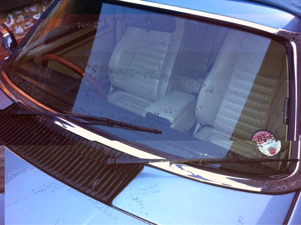

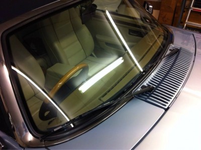

Re: windscreen wipers
Below a couple of photos
David
are you positive that your 89 car has Lucas motor wipers , as the parking position would indicate it could be Electrolux,
the only real way to know is to pull out the wiper box
or check the vin , lol
for those that dont know what the main difference is , well its all about the wiring,
the bulkhead multiplug is different , with more ( ? ) wires for the electrolux wipers, the control module is different and the stalk control is different from the Lucas setup , the two are not cross compatible
BB
