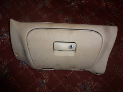

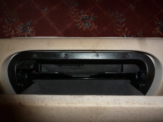

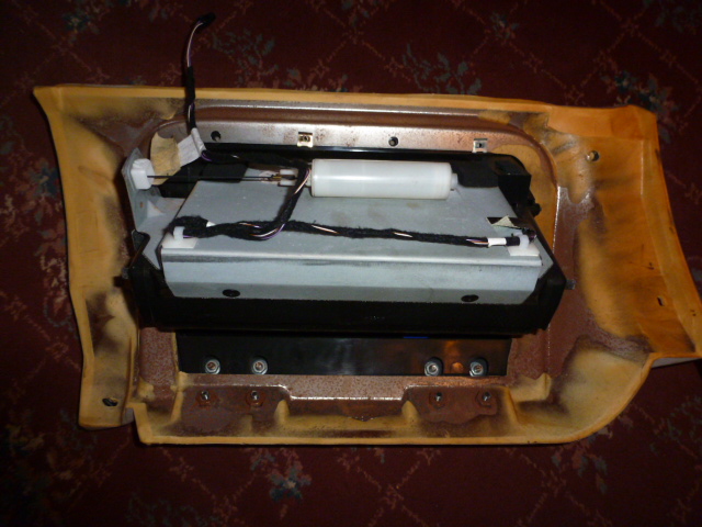

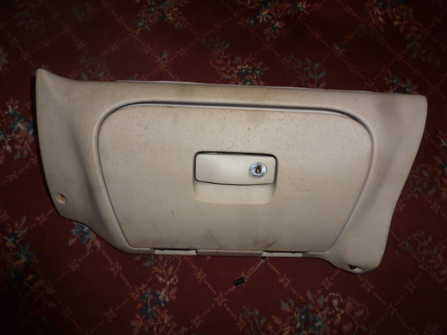

Re: Glove Box Availability
three pics of a glove box removed from the car
10 minute job to swap over
this one was in the depths of my stash hence it needs a good clean, I have two more, no keys but all unlocked
if one is of use let me know £40.00 posted (quite chunky items)
