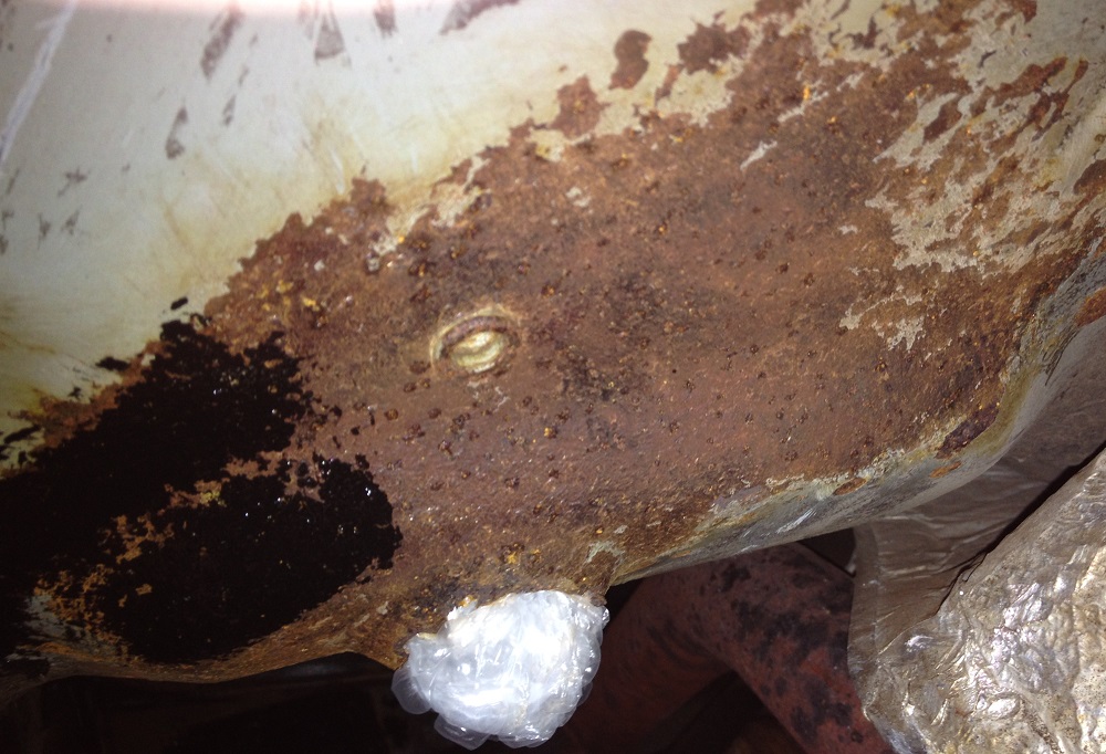

The reason the seats are up is because I have pushed the ABS sensors through the floor for rear subframe removal. Steve was bang on, they were well and truly seized onto the hub carriers so not even going there!!
The car needs welding floor to sills so I thought would strip interior to save sparks damaging upholstery. I may be able to shield the squab though, however have a look at the rust around where the abs sensors fit through. Would you cut and weld or wire brush, prep and POR15? If it's POR 15 I may leave the squab in situ then as I have enough jobs to do on the old girl.

mmm, I'm not really a bodywork bloke, but common sense seems to say to me, cut out the rot, put a plate in , paint and treat however you wish, then remake the hole for the abs sensors, make sense??

Thanks Rob - Yes that makes sense to me so it's out with the rear squab along with the carpets and grind back to see what needs cutting. Thanks again for the advice.

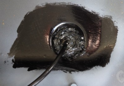

In the end the list of other jobs to be done on this car and other more serious rust issues meant that because this rust area was in comparison fairly superficial I decided to grind back to clean metal and treat. I can always come back to it at a later date. I broke an escutcheon taking the back of the seat out (despite the warnings) in my enthusiasm and it was not really necessary in any case and very fiddly to do.
The end result was o.k. I think. Given the likely value of the car I guess a line has to be drawn on how far to go initially on the rust front and treat the most pressing areas first. The car itself is a bit of an unknown quantity since it clearly had a dodgy MOT. Here is a pic of the hole from the top. The underside is all treated and painted up to protect for a while.
Sealant applied to prevent damp ingress and secure the ABS lead.
