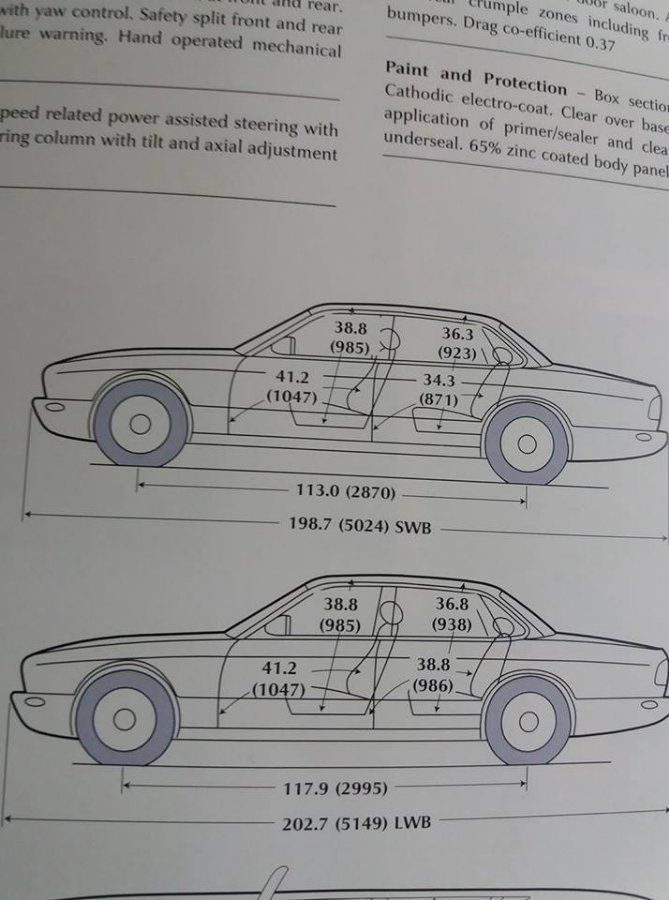

I am new to this Forum and hope you can bear with me on making this post, I have a 1995 Jaguar X300 Sovereign which I purchased 4 plus years ago only Just recommissioned November 2023 and still with a number of issues to be rectified. First question could anyone please kindly provide information on where I may purchase a New Quality Headlining, and secondly I was told it was a LWB Version but the Heritage Certificate does not state this.
Does anyone know what the rear door measurement should be too confirm whether SWB OR LWB, as will obviously affect which HEADLINING to Purchase.

Hi huyton61791,welcome to the JEC Forums.
I have a X308 LWB and the rear door measured along the coachline is 44" or 112 cms.
The X300 and X308 share the body.
See the photo for the other dimensions. For the headlining there is Myrtle LTD.
https://www.myrtleltd.com/jaguar-daimle ... Headliners
I have heard good and bad feedback on them but have not used them myself.
There is a company that advertise in the club magazine,Studio Cars I think.
They are normally in the classified section.
Hope that helps.

Many thanks for the reply I will now use the information you kindly provided, to ascertain what the vehicles status is.
