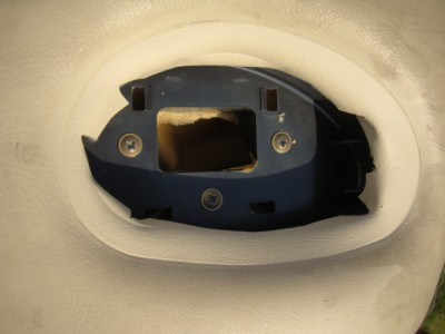

Advice from another website was to put a large flat bladed screwdriver under the edge of the whole switch pack and leaver it out.I was able to remove the switch pack from the plastic aperture (photo attached-hopefully )which is glued into the foam of the seat. On the seat that was donating the frame, the whole pack came out complete. Unfortunately, on the seat that was donating the trim and the matching switch pack, one of the 4 plastic tangs broke. It is just about possible to see the two lower tangs looking through the frame, but access is very limited to try to release them from the two lower slots in the aperture in the photo. The upper two tanks are very difficult to see from the inside because they are obscured by the foam. When I got the switch pack out, I could then remove the three screws that hold the plastic aperture to the frame (also shown in the photo). I was then able to remove the foam with the leather trim still covering it. I then transplanted the foam and leather cushion to the replacement seat frame. The switch pack was refitted with the three remaining tangs and seems secure. I've now taken the switch pack off two seats with a 50% success rate. I still don't know how I would do it differently another time. Good luck to anyone else trying this job. It feels like this arrangement was designed to go together once, but nobody really thought how anyone would take it apart again.
Photo of plastic aperture in foam cushion into which the switch pack clips

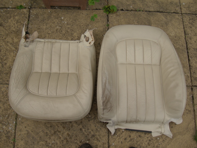

I now have a set of leather back rest and lower seat cushion for a driver's seat that I don't need from my donor seat frame and so I'm happy to give them away. They are in poor condition (usual wear on side bolter) - see photo. If anyone wants them let me know. They can be collected from the Northampton area.

Postby ptjs1 » Sun Sep 21, 2014 9:34 pm
Andy,
Well done for working it out. After your first post, I went out to my x308 and tried to work out if I could prise off the outer cover to report back to you. After much effort, eventually, I realised I was probably going to snap it off if I continued , and now I realise why!
