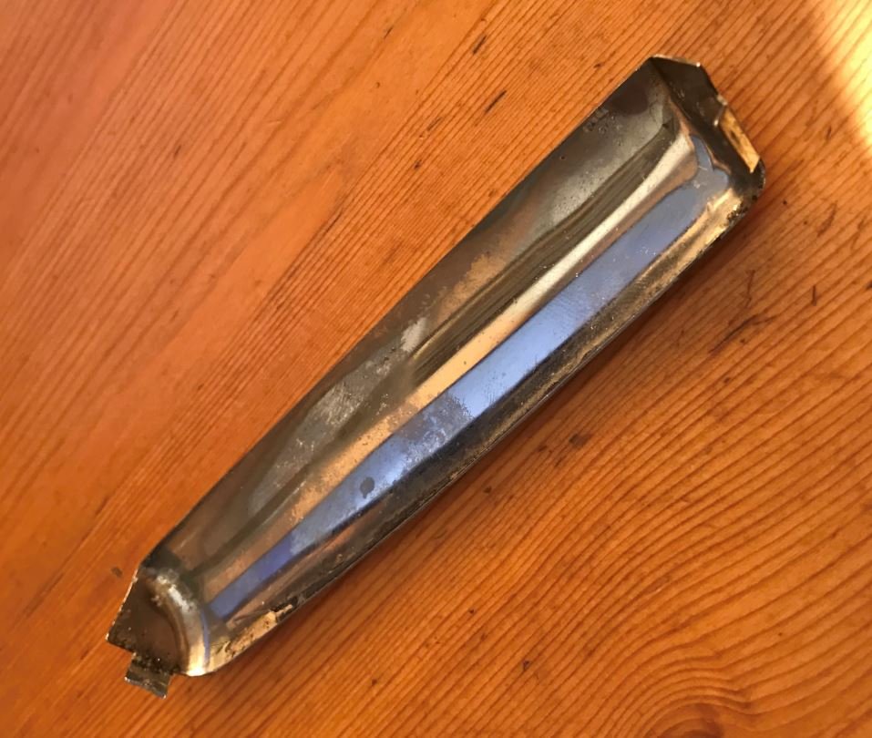

As an aside, I’ve found another version of the lens. It has the same reference SPARTO No. 5911 but a slightly different design.
The one on the left has a rebate in it, though that’s not visible when it’s enclosed within the lighting unit. Also, instead of having shaped holes to take small metal spring mounting clips, it has round holes that fit directly on and snugly around the mounting pillars of the lighting unit.
All to no avail in my case as if you look closely at the lens on the left, you’ll spot that one of the mounting holes is also damaged. I tried it on my light fitting and sadly, because of the damage, one side is loose. The other side fits like a glove.
