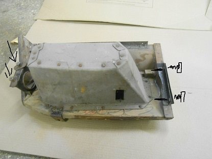

Can anyone please advise how to remove the glovebox from my 1965 mk 2? The dashboard top is off, as is the panel underneath. I can see the two securing nuts on the right hand side, but can't see how it's secured on the left hand side. I would appreciate any advice.

Like the song , a picture paints a thousand words !

in order to access the left hand attachment bracket, you need to remove the small piece of glovebox lining, it's glued in, but not firmly. You will then find there is a round access hole in the glove box lining . It is quite fiddly to get a spanner in there to undo the two nuts.
