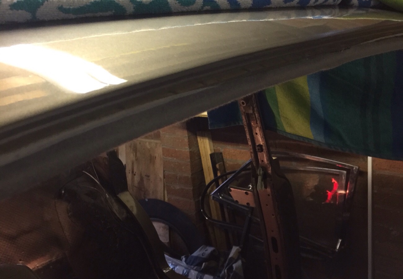

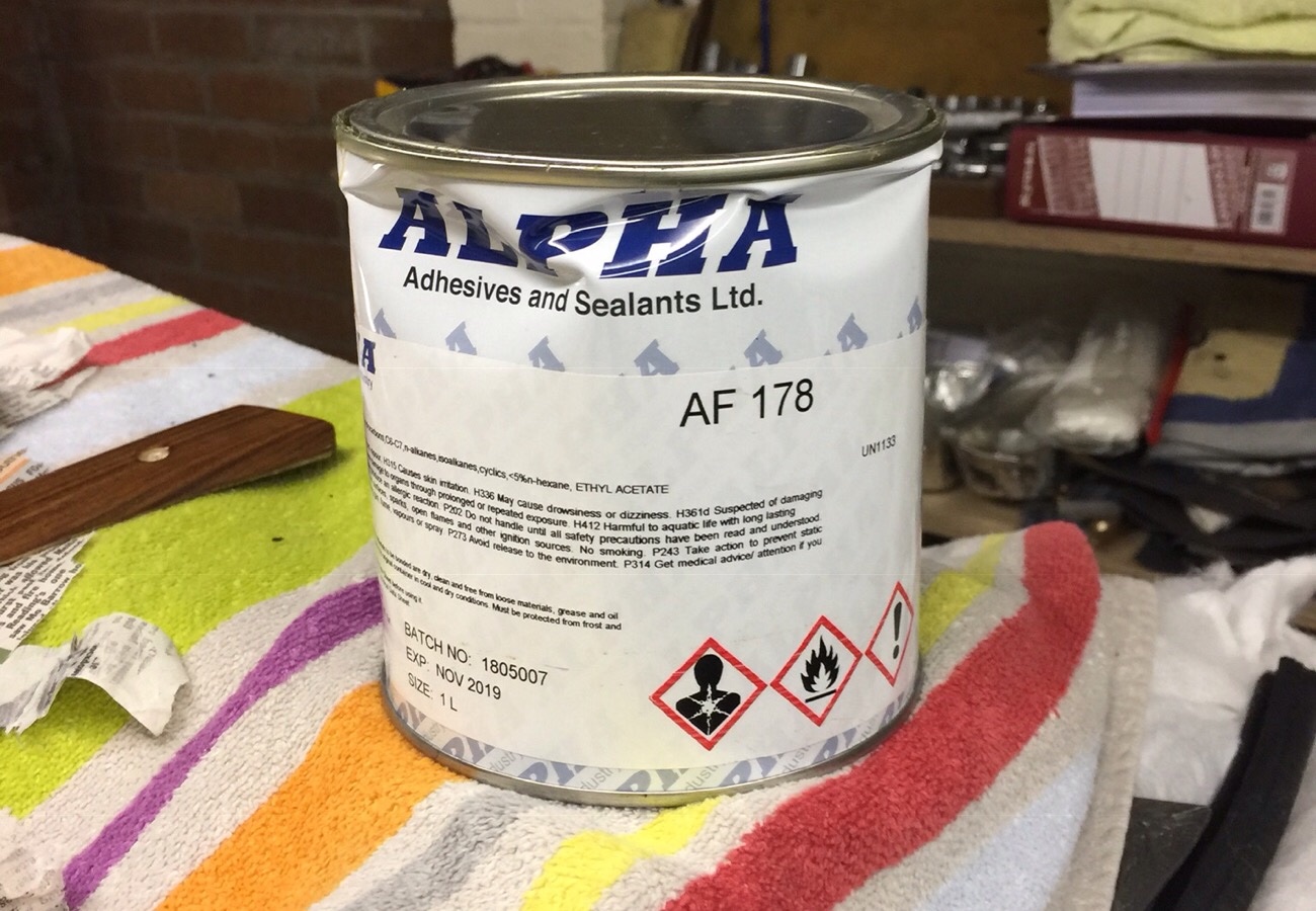

Had the chance to snap a few pics today as requested although how useful they are I'm not sure. Firtsly I stuck everything with the glue in picture which i got from woolies, used it too for the boot seals, brilliant stuff. Coat both sides and leave for 20 minutes, even with some tension across the headliner it sticks immediately and allows manipulation for a few seconds, then its as good as staples.
Along the cant rail above the doors I stuck the headliner to the tacking strip face and to the underside so that it will be a smooth transition from headliner to the wood, when fitted. ( there is a little lack of tension in the middle of the picture as the tacking strip stops each side of the interior light which when fitted will cover this up)

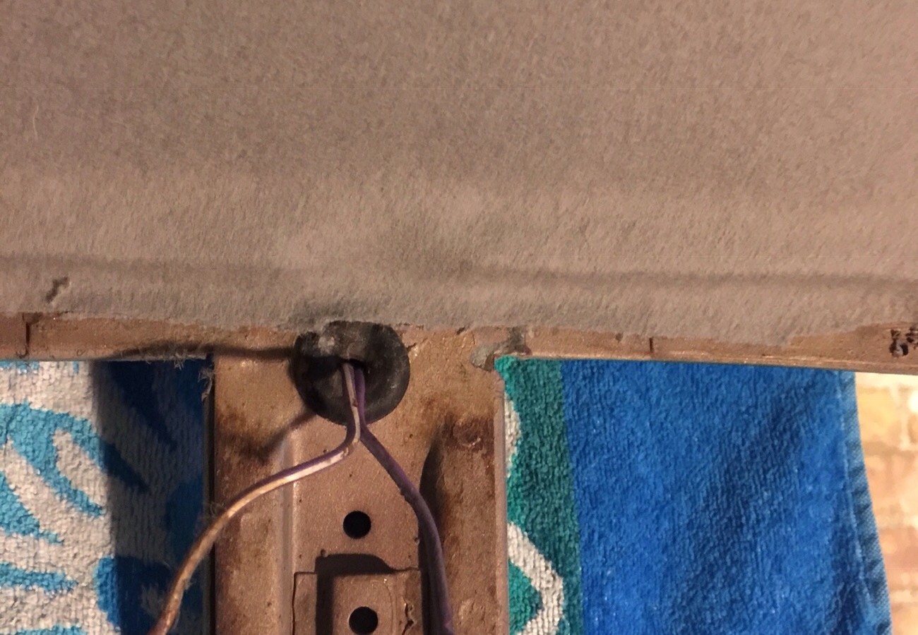

At the front i stuck the headliner to a return on the metal cross member onto which the rear view mirror and sunvisors mount. This allows the front windscreen rubber to mount onto its own rail.

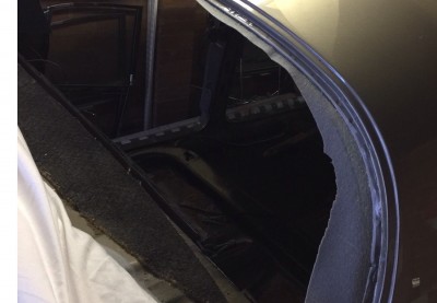

At the rear i decided, as i did not see another option, to stick the headliner upto the rear windscreen mounting. I did not return the headliner around the rear screen mounting, hopefull this is correct although I have yet to trim this so could modify.

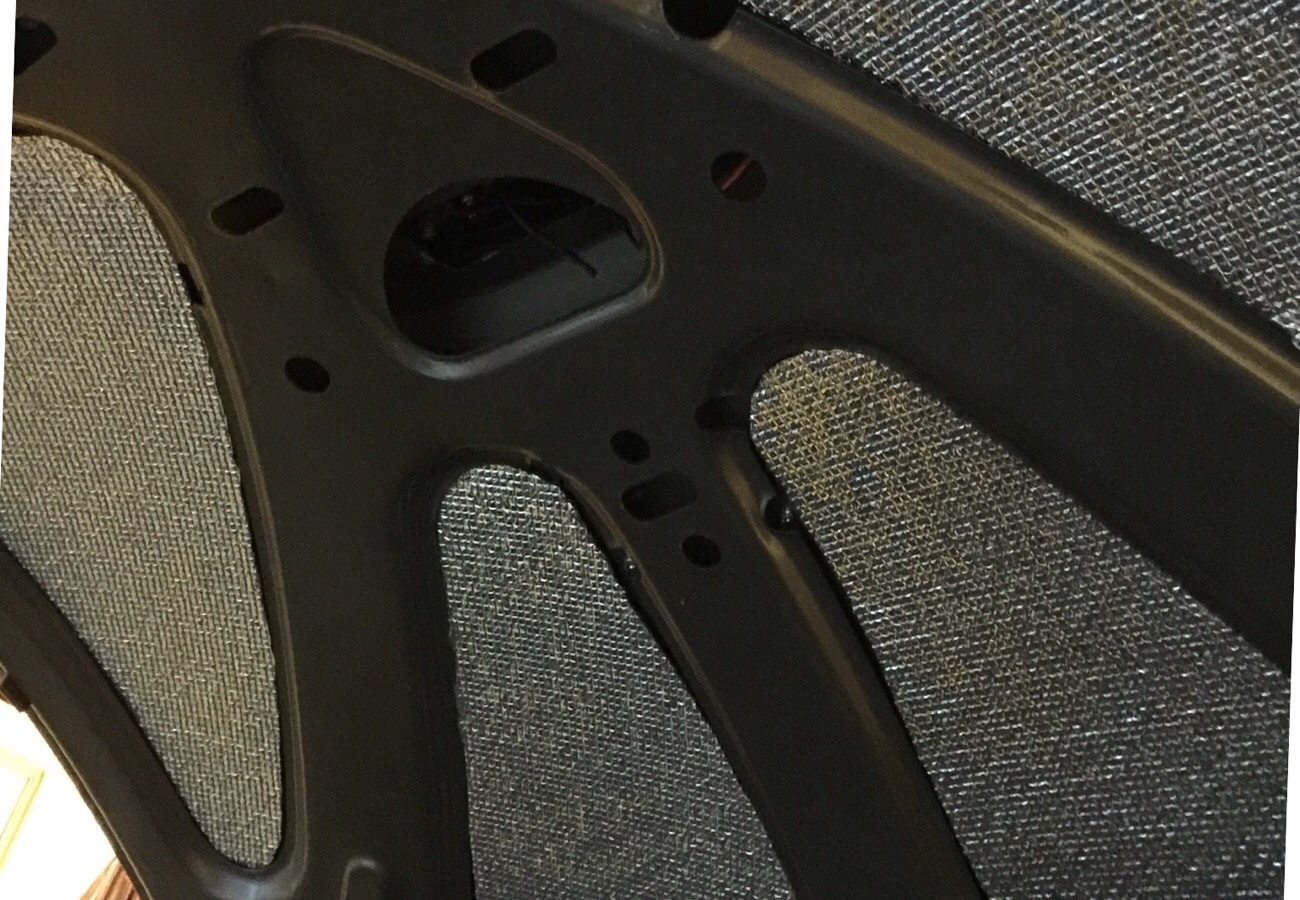

Paul, after hours of dusty arm aching work to remove the original, i was recommended a product i bought on ebay. Item number 282682035197 which is self adhesive and foil backed to retain heat in the cabin. I used what i had left from my order of 2sqm to line the boot area which i have been able to photograpph. I cannot vouch for this product yet but i trusted the recommendation, it was very easy to work with cost effective.
