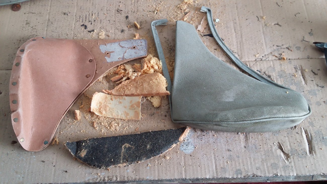

Are we talking about the Door card arm rest ?
If so its a straight forward job really , I rebuilt all my door cards , with new board and foam !
The arm rest is held on the card with a few screws , you would need a good tack gun for the staples !

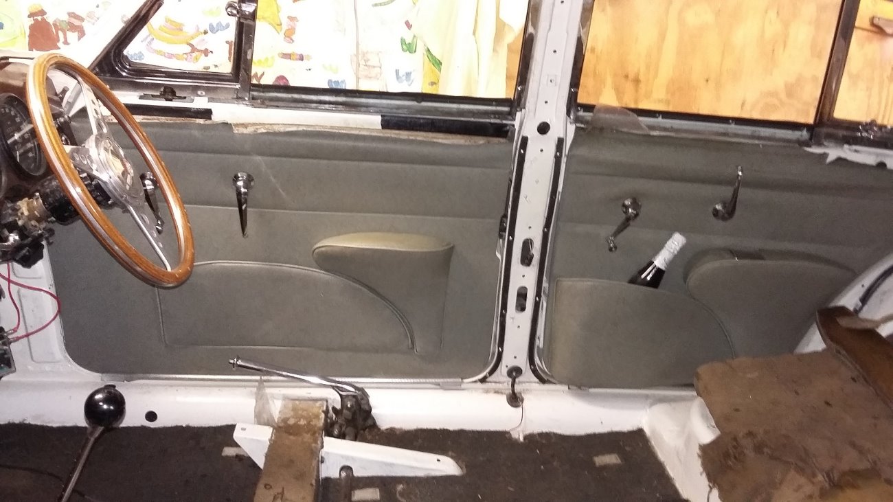

Nice job there.
Yes these are the front door card armrests as shown in your picture.
As I have not taken the card off the door and detached the armrest I am not quite sure of the manufacturing methodology. However I have noticed that Aldridge Trimmers offer Item 207JMK2/AR2 FRONT ARMREST COVERS at a reasonable price, which indicates to me that the top part of the armrest (with the split and collapsed foam rubber internals on my car) is a replaceable item?
I am trying to speak to someone at Aldridge's to confirm this, but what its your take?

Hi, if your vinyl material is in good condition then it is a simple if slightly long winded job to strip the door card down and remove the armrest and then repad it. I enjoyed doing mine several years ago.
