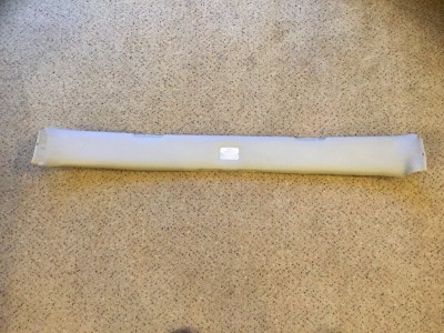

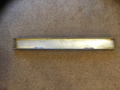

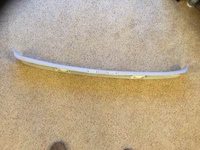

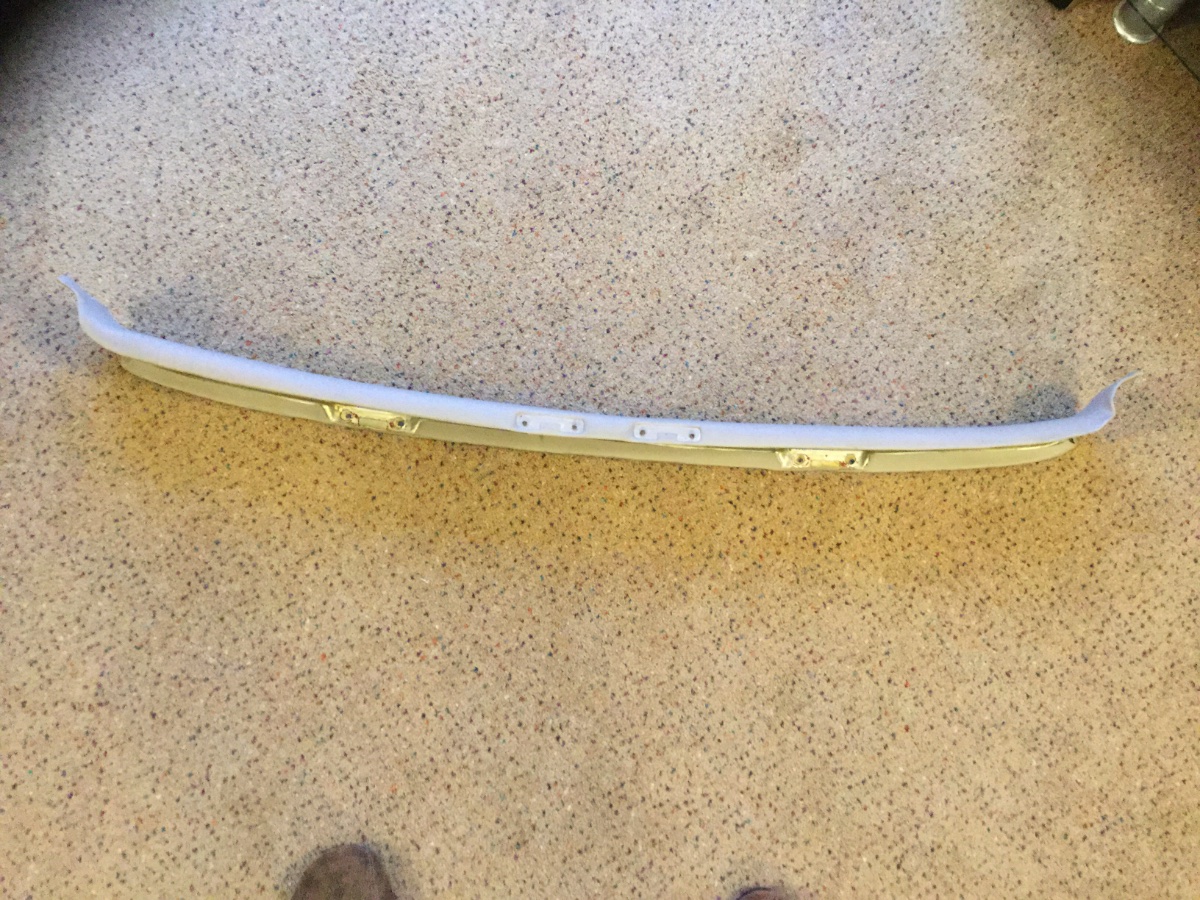

I should have documented the procedure with pics and as I have now refitted the panels I cannot help much to your request. I have a spare panel that has not been recovered, so I have attached pics of it to show how much material is glued on the underside of the panel.
Alan

One picture attached.
Alan
