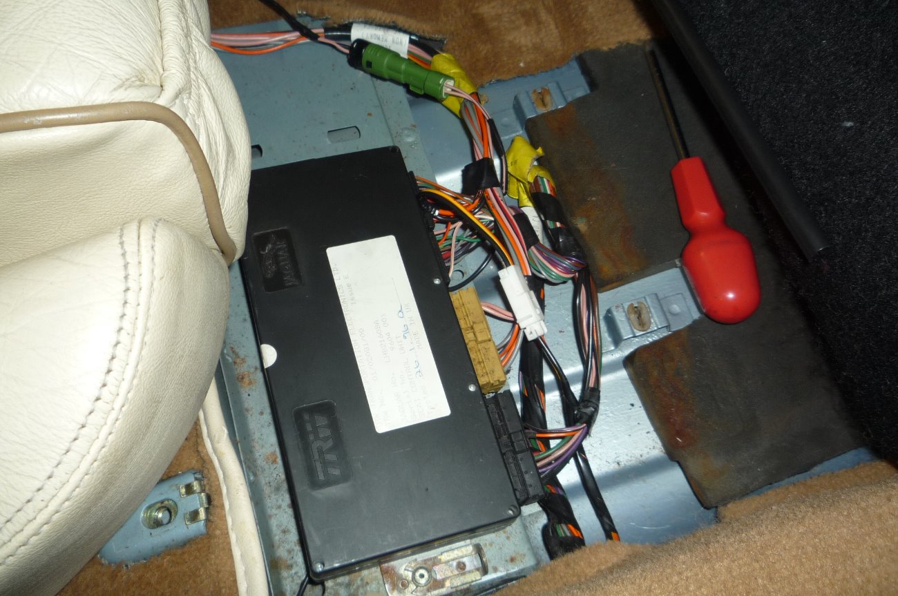

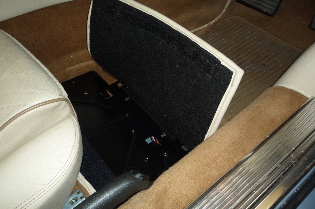

The seat control module and connections are all under a metal plate just in front of the seat. This is where the connections are. There's no need to remove the seat to check them. Even so, removing the seat is only a matter of 4 bolts so not that hard.
Lift the carpet and remove the 2 screws at the front of the cover and this is what you have.

I hadn't clued in that both front seats were behaving the same way. They are independent so I can't think there would be a common fault that could affect both at the same time. Usually the fault lies in the control units. I've not heard of the actual seat motors packing up.The heater motor is not too hard to replace.
