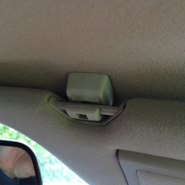

as most XJS owners have experienced this frustrating broken sun visor clip , i thought i would try and make a better fix other than throwing a new clip every time they break
the clip is screwed to the roof by a philips screw up inside the clip , the construction of the clip means that stress is placed in about the worse place it could be , and the clip breaks as below

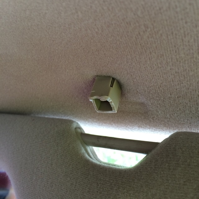

and this is what is left screwed to the roof

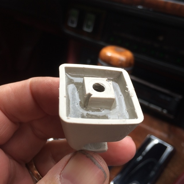

my attempt at creating a better fix is to mix up some epoxy resin ( 2 part ) and rough up the inside of the new clip so it gives the epoxy something to grab onto , and then carefully fill the recess with the epoxy resin to just below the top as shown, this epoxy resin sets in 5 minutes, and is fully cured after 24 hours, so do it the day before fitting
IMG_2536 by MyPix on Talk Photography
then simply screw back in place as normal, hopefully the epoxy will support the weak point of the clip to prevent future breakage , only time will tell
IMG_2538 by MyPix on Talk Photography
this won't repair a broken clip as the plastic doesn't seem to like being glued, its simply supporting the internals of a new clip before fitting , clips can still be bought new from Jaguar for about a fiver each
