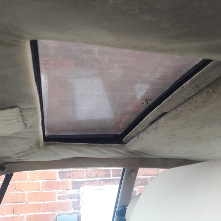

Thanks for all your tips, the coolant leak appears to be the wing mounted expansion tank, will order one and two new caps and see if that sorts the leak. Coolant looks nice and fresh anyway, no doubt due to the need to top up regular.
The headlining is RIP but to complicate matters a little it has a factory fit sunroof which judging from how many sunroof headliners are available it maybe a rare option? It maybe the sunroof model has different setup headliner wise than the usual board system.

Re: New owner, XJS V12. Hello.
John - chin up! It's not that bad!
High idle - as we've already discussed, likely to be an air leak or a stuck auxiliary air valve.
Coolant leak - rusted out expansion tank is a known issue. Hopefully the replacement will fix it
Headlining - you are right in that cars with a sunroof are trimmed differently. Are you sure it's a factory sunroof because there weren't many? Good news is that sunroof cars are far less prone to the headlining dropping as the sunroof holds it up. There are specialist cleaners that are good on mildew stains so it may be rescued.

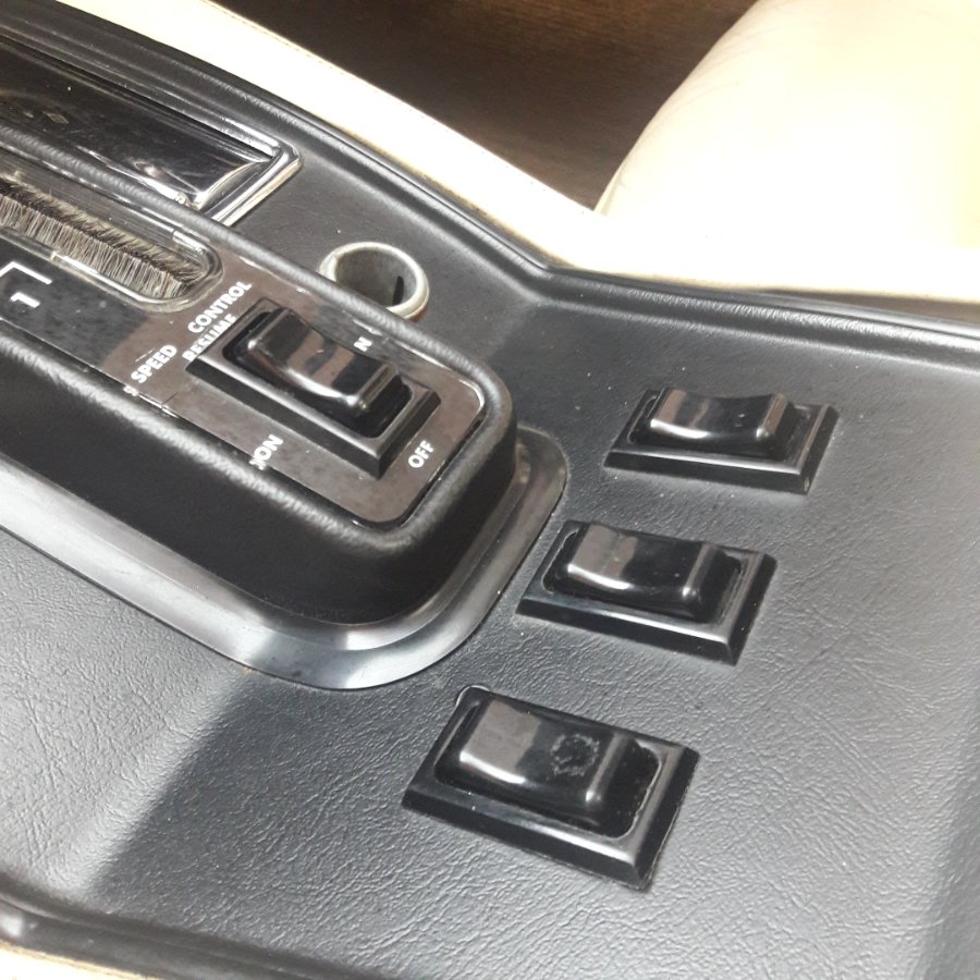

Thanks for that, I've spoken to Jag Breakers in Bolton (thankfully only 10 minutes away) and sorting some bits out with them now.
The electric sunroof has the button to operate in the centre console between the window switches and is an OE switch so i just assumed is a factory sunroof no idea if it was a rare option or something thats fitted retro at the dealers maybe? Any way to tell?

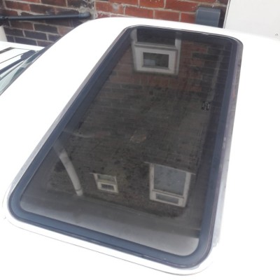

John,
On the face of it, I would guess that's a rare factory-fit sunroof option. I've not heard of a dealer at that time, cutting the roof on an XJS to fit a sunroof. If you post some pics of the roof and switch, we could probably confirm.
You could also apply to Jaguar Heritage to get a Build certificate for your car, which should also detail the factory extras with which it was built.
Good luck
The glass has manufacturer mark Sekurt and some numbers.
That glass mark is probably "Sekurit" who make a lot of the original automotive glass.
The interior switch looks original. One of our members - BrakeBuster - has an XJS with an original sunroof. If he sees this thread, he can probably confirm its provenance. Having said that, the headliner does look like it's past it's best!
Ohh yes the headliner is very sad indeed. Long past saving.
It was doing enquires into getting a replacement when i realised sunroof models are not exactly easy to find so will have to have one made I guess.
