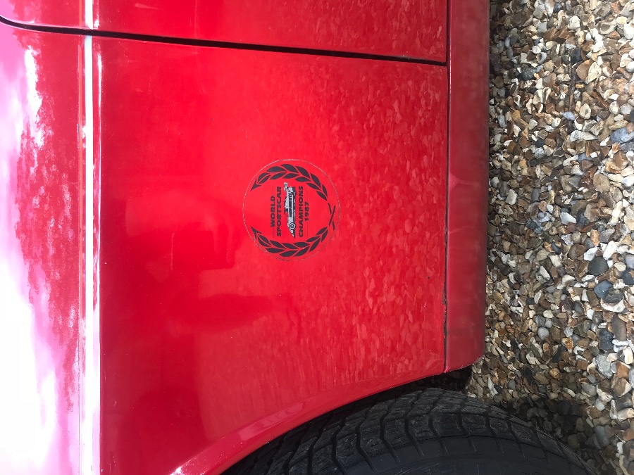

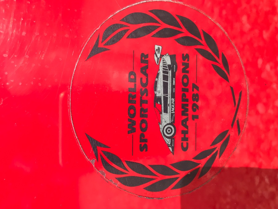

The bit I’m really struggling to get my head round is why the car has got an XJR-S chassis number (5th digit S) it all looks very original and not tampered with. The car is badged XJS V12 on the back. The only other badges are stickers on the front wings behind the wheels saying ‘World Sportscar champions 1987’ which I’m guessing refers to the Le Mans victory....has someone just stuck them on....or could it have been Jaguar when it was in their ownership? I’ll try to add a pic.

From what you have described it sounds pretty unlikely that your car is an R. I have attached a picture of what the engine should look like with the Sports rocker covers. The 1987 stickers refer to the World Sports Car Championship rather than the 1988 Le Man win with the XJR-9. It might be worth seeking out some expert help from someone like Nigel Thornley who has written countless Jaguar books and edits the JEC magazine because an awful lot doesn't add up.
