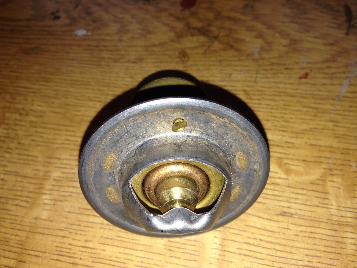

Having driven it a bit today, I think I need a new thermostat as it doesn't get warm and the rad caps seem to be the original 33 year old jobs! I think the overflow is allowing a bit of water to escape as well. Recommendations for parts suppliers?

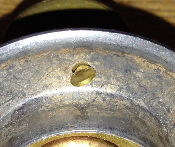

There are 2 thermostats - one for each bank.
When you put them in make sure that the giggle pins are in the 12 o'clock position - this makes sure that the air can escape. And don't panic! I'm talking about prudent preventative maintenance and if your car isn't overheating then nothing to worry about. Making sure that your cooling system is in good condition gives you further peace of mind.

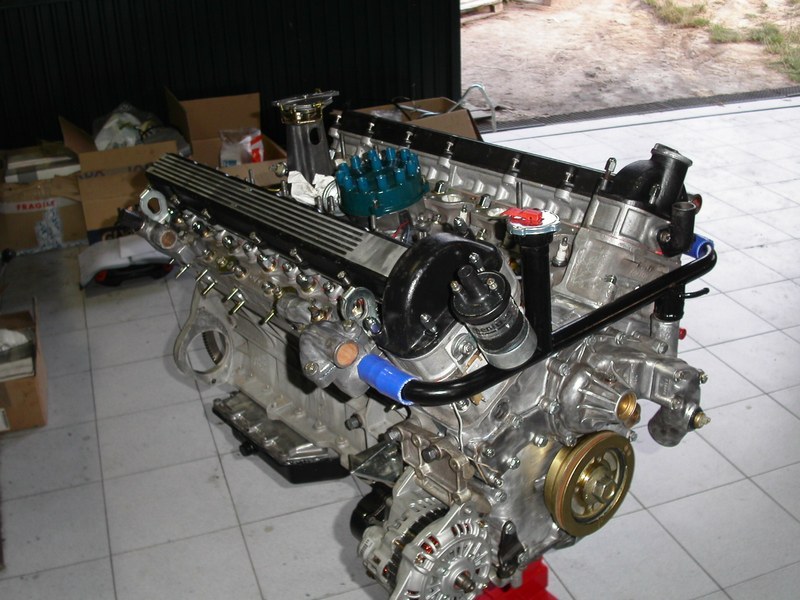

There are 2 thermostats at the front of each water rail running along the outside of each cylinder head.
On this image you can see the black cross rail running across the front of the engine. Where they are connected by the blue hoses they are the thermostat housings. 3 bolts on each I think The thermostats look like this. Make sure they do have the giggle pins. Do not fit ones without or air will be trapped behind them and you will not be able to fill the system fully. As I said, fit the thermostats with giggle pins at the highest point. It may be best to order a couple of gaskets as well. They are different for each side. Part numbers EBC8330 and EBC8331 I think will apply to your car but there are variants so best to speak to the guys from David Manners and check. If you have your VIN and engine number to hand that will give them what they need. Also check that you have ordered the right temperature thermostats. They come in 82 degrees and 89 degrees. Yours are most probably 89.
Hope that helps
Hope that helps
