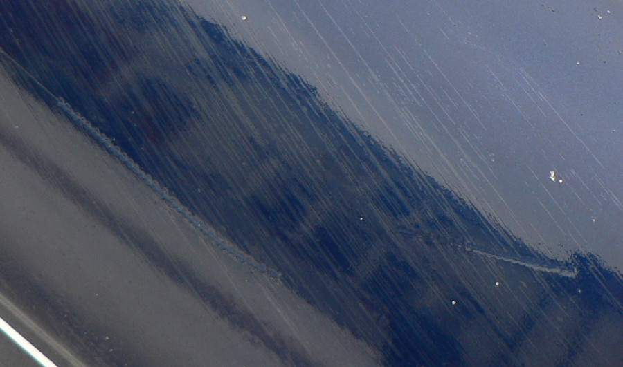

Good article, Mike. Someone ('er indoors) has had to use the Sport due to unpredictable starting of Ludlow (see other thread) But had to fill up with the car to the wrong side of the pumps. The pump filler jammed in the
car's filler and so she twisted it to free it -- predictable result pump filler trigger shroud scrapes bodywork before releasing.
Alright, it's only a surface scratch, but a surface scratch that T-Cut only tends to darken, not remove.
Asking around and seeing what wisdom there's on the interweb I get a different answer every time.
From keep on using T-Cut and "it'll be alright" to "oh, the whole panel will have to come off otherwise you'll
never get a good match".
I've got the very fine paper, a holder for it, some wood blocks to wrap it around if needed, aerosols of primer, correct colour made up especially, and clear. But me being me I just know I'll make a hash of it if I try without
some guidance. As this is X308 unsure what bits of your alu metal article are relevant
Here's a pic (moisture wipes overall) ... "Painting in cold weather is not advisable and just invites trouble." quote from Mike's article
Good advice. Which I showed to 'er indoors...
