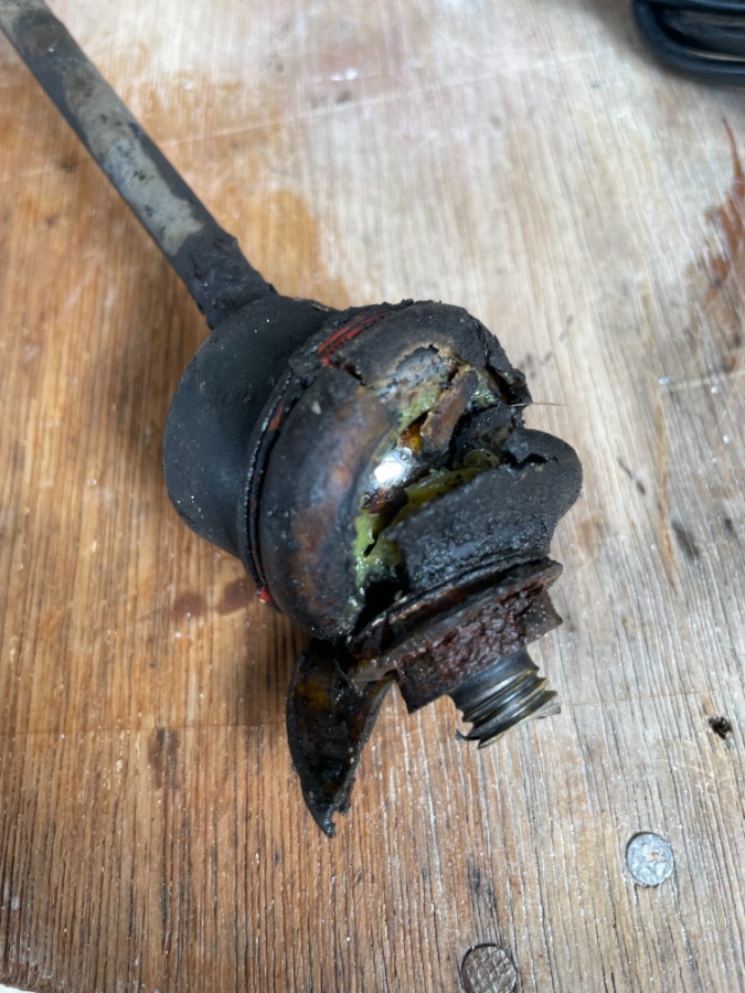

Heard a slight knock from near side rear.Had a look and found the bottom bush of the damper flexing when I applied pressure on it with a bar. I looked around at the other joints as you do and the photo shows the state of the Roll bar Link. I replaced the damper and the drop link , bought a pair of dampers and drop links from Brit Parts . Now need to replace the offside when the weather permits.

It's surprising how well Jaguars drive and handle, even when steering and suspension joints are well past their best.
