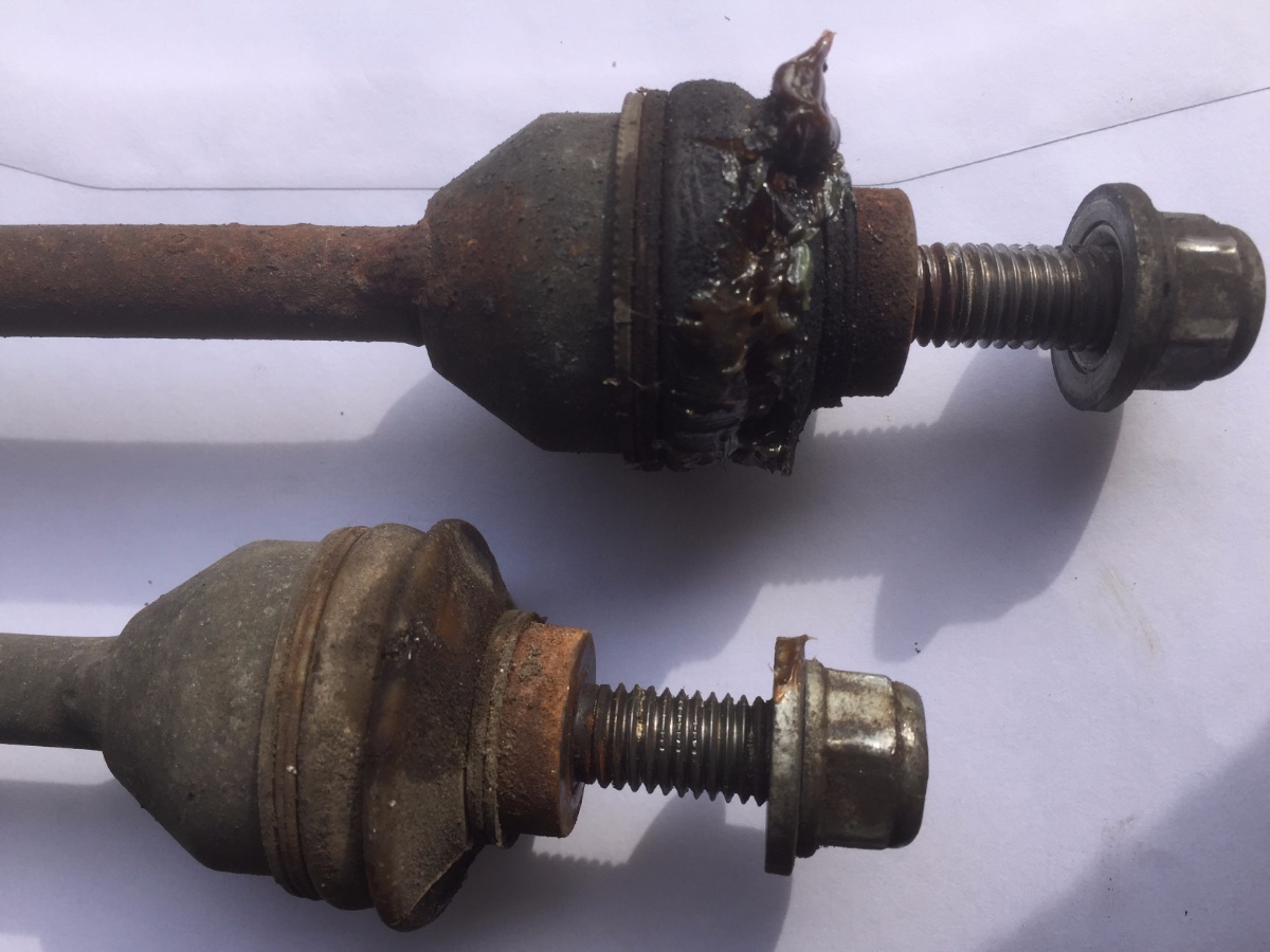

IMG_6479.JPG[/attachment]

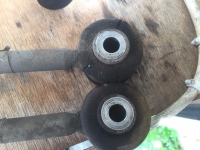

Both Rods are showing sign of perishing both ends. car at 90K miles and 9years old.

Nearly always gone after about seven years or about 75k miles.....sometimes faster dependent on road contaminate and often high UV conditions. Those do look rather a mess!
