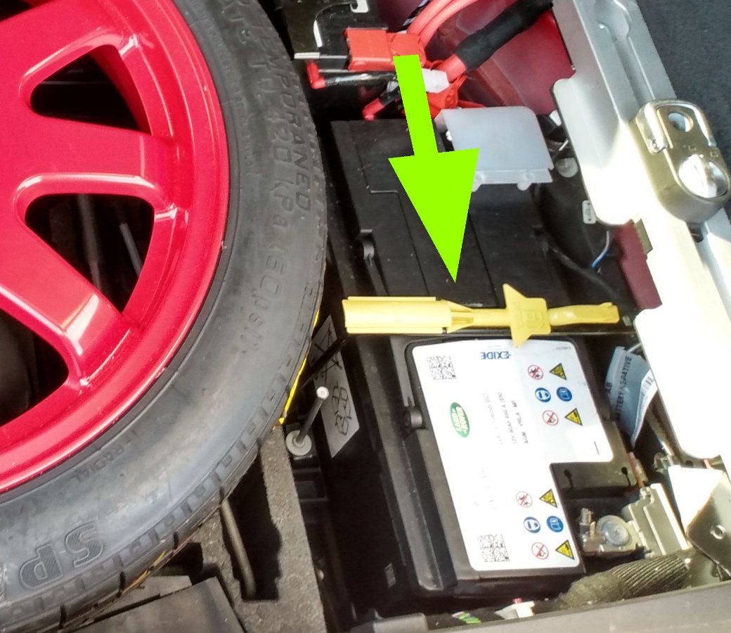

On a diesel there is a mis-fuelling prevention device which puts a yellow flap across the filler neck. It is supposed to activate when the wrong sized (petrol) nozzle is inserted, but can activate itself under other circumstances. It produces symptoms very similar to those you describe.
Have a look into the filler neck and see if you can see a yellow flap partly blocking the passage. The tool for resetting it should be on the battery clamp. Instructions for using it are in the handbook.
