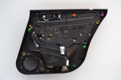

I've just replaced one of the door cards and that description by Paul is spot on.
The only thing I'd add is that the clips don't come away easily and it takes a bit of levering around the edge of the door card.
With your lever, try and peek around the edge to see where the clips are and where to apply pressure. I started at the bottom and worked my way up both sides.
Attached is a photo of the back of the card which shows where the clips are, 7 in total. The yellow prongs are just locators not fixing clips
