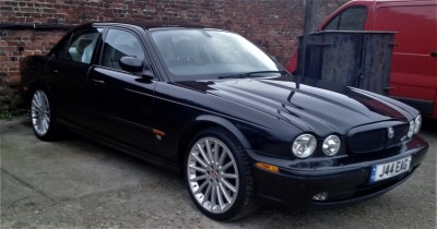

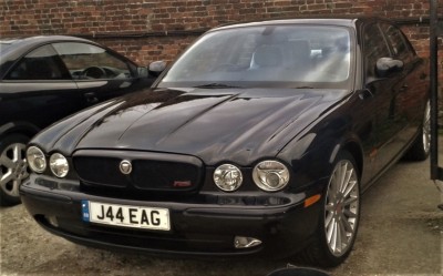

Here is my XJR. Post a few images of yours for us. Very interested to see what you have. Keep in touch.
